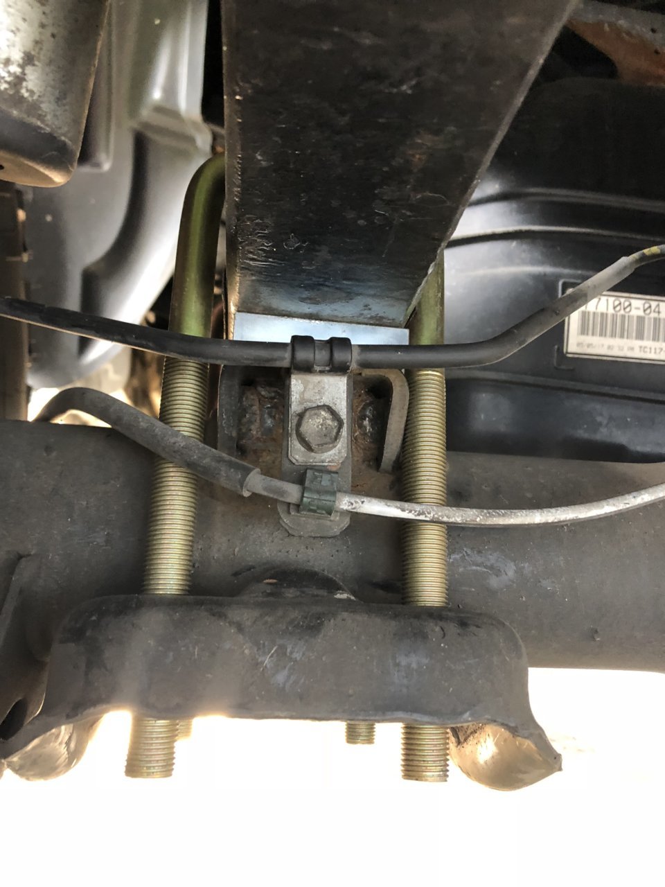

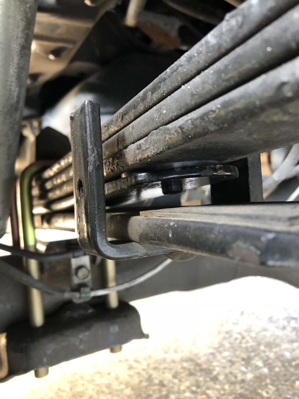

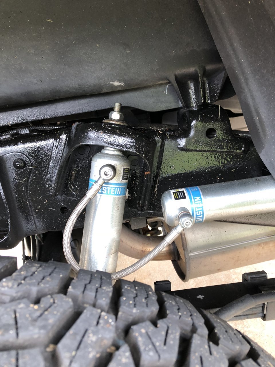

    Yeah 5160’s with a 1.5 AAL and 3 degree aluminum shims gives a nice quiet squeak free and vibration free ride...although it’s slightly stiffer than stock I’m still very happy with it.
