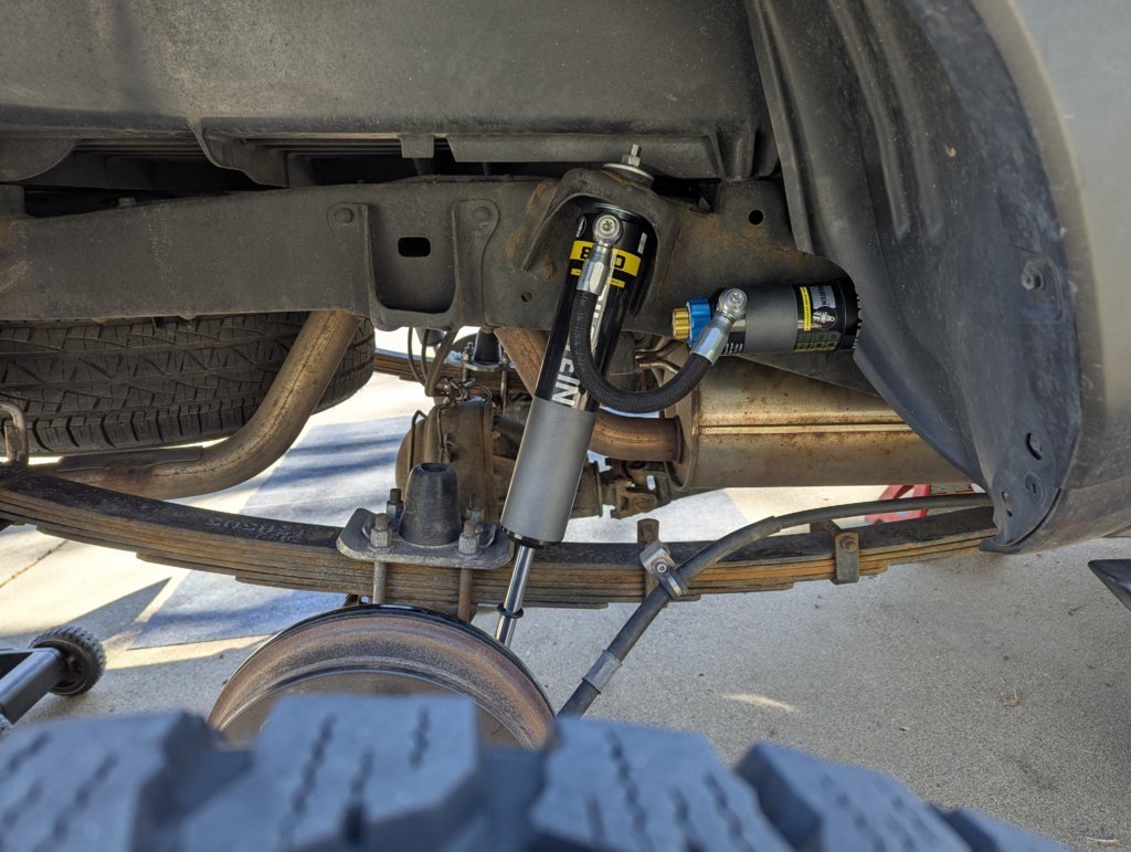

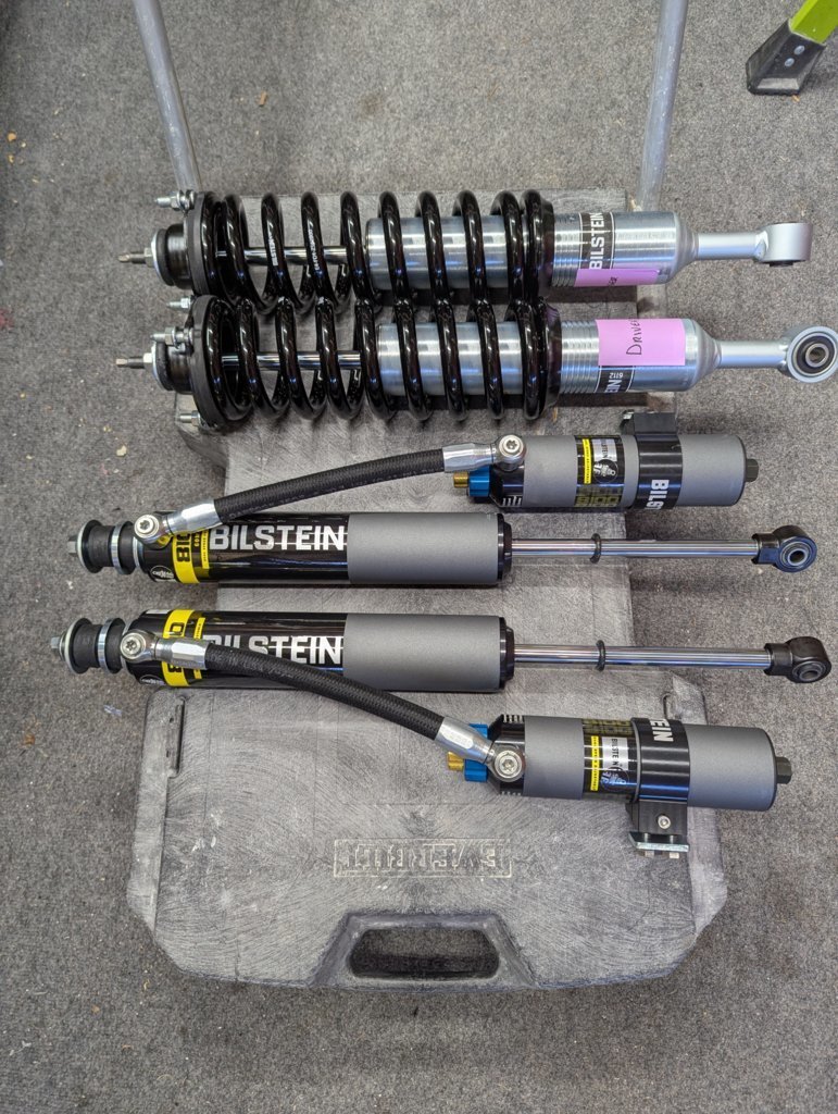

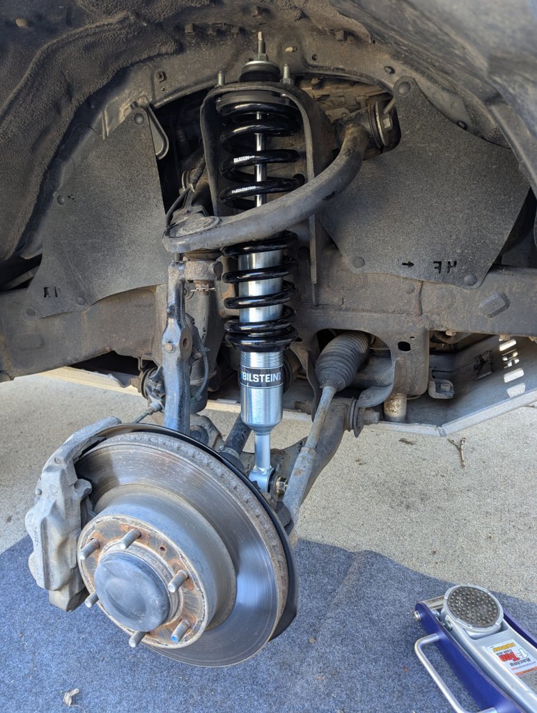

    This seems to be a weird combo that either isn't done very often or at least not spoken about on here so I figured why not, it's only $2500.
    I got the new Bilsteins from Hotshot Offroad, because he is awesome.
    These shocks are replacing Dobinsons twin tube shocks, which were better than stock and are pretty good both on and off road but they were not good going much faster than 30mph on low maintenance roads. And I only had 600lb springs on them that were starting to sag under my fatty of a truck.
    My truck fully loaded for adventures is around 6000lbs and everyday driving around 5200lbs.
    What sent me down this path is last summer I was chasing a SxS on a minimum maintenance logging road at 35mph and though I was having so much fun it felt like my truck was going to rattle apart. So I was saving up for Dobinsons IMS/MRR until I found Overland Outfitters - Shock Value videos on YouTube, the Dobinsons didn't do to well compared to the others. The Falcons, which they loved and seem like if you had a stock truck would be the absolute best option, don't have heavy spring options so they wouldn't work for me. It was then a choice between Icon and Bilstein. After talking with Colton he steered me towards 6112 paired with 8100, and talked me into spending the extra money for the DSA model since my truck varies so much in weight depending on what I am doing.
    Up front I have the 6112 w/ 650 springs and circlips set at 5/7, which so far gave me 3/4" of lift and no Taco lean.
    In the rear I went with the smooth body 8100 DSA set at factory specs and paired with Icon RXT leaf pack option 2 (which I already had and also purchased from Hotshot)
    I have had my sway bar removed for a few years now and can say the new 650 springs are more stable than 600lb springs, less body roll and a lot less brake dive.
    On my test drive down a nearby rough road I was able to go much faster than before. I got up to 55mph going through potholes and almost airborne going over some train tracks, before I would maybe go 35mph and slow down a lot to go over the train track bump.
    If the road was longer I definitely could have gone faster. This weekend I will hunt down so long gravel roads outside the metro to do more testing.
    Maybe when I need to rebuild the rear shocks I might go with 8112 up front too, but right now the full 8100 experience is too much money for me to want to spend, around $4000 including new UCA.
    I will update this thread when I have more info on how they perform loaded up later in the summer.
    I am going up to the north shore in June and will drive a trail called Gandy Dancer which everyone says is just 30 miles of really rough road so that should give me a really good idea of how they preform. And in August I am going to Texas where I plan on driving Padre Island.

    Finally got out on some gravel roads and holy smokes are these shocks amazing.
    I was just flying down the roads (45-55mph) even with my tires at 40psi the washboard was like riding on pavement and I hit every pot hole straight on. It was almost a little scary because I could go so much faster than before.
    I turned down the rear shocks 2 clicks on the high speed since my bed was empty.

    So far I am very happy that I spent the extra money for the bigger and adjustable rear shocks.
    My only regret is that if I had just gone full 2.5 from the beginning, instead of just putting on extended travel twin tube shocks, I could have gone full 8112/8100 for how much I have already spent on the 2 shock setups :(
    I usually am pretty good at doing the whole buy once cry once thing but suspension is one of those things I have never replaced in my 20+ years of driving so I didn't realize how much better it could really be.

    Main downside to the 8100s in the rear is they give you less suspension travel than some other options. Going fast on dirt roads it doesnt really matter but the extra suspension travel is super helpful for rock crawling and rougher roads/trails.
    ssd2k2[OP] likes this.
  16. Apr 27, 2025 at 11:17 AM
    #16
    Mach
    Mach Well-Known Member
    Oct 9, 2024
    #458465
    319
    2022 Lunar Rock DCLB TRD Off-Road
    8100s are 22.8in extended. Even the stock OR shocks are 22.94. When running a thicker leaf pack like the RXTs or a 1in spacer you can use 5125s that will give you an extended length of 24.35. An extra inch and a half of droop means your wheels arent going to have to leave the ground on bigger bumps at speed and in cross axle crawling situations.
    I havnt looked into it but there may be some suitable length Tundra 8100s.....
  17. Apr 27, 2025 at 12:59 PM
    #17
    ssd2k2
    ssd2k2 [OP] Well-Known Member
    May 27, 2020
    #329548
    1,125
    Keith
    Minnesota
    2019 Tacoma TRD Sport M/T
    That was a consideration of mine, before I bought the 8100s I did look up the Tundra 8100s and they are an inch longer so I would lose up travel.
    The kinda off roading I do the stock 8~" of total travel is enough for me, I try to never do trails harder than level 5, and personally for my needs I would rather have more up travel than more flex.
    But everyone has different wants, mine is more exploring off roading, where I can get to a destination vs going to an off road park to see how hard I can push the truck.
    Mach[QUOTED] likes this.
  18. Apr 27, 2025 at 1:43 PM
    #18
    Mach
    Oct 9, 2024
    #458465
    319
    Wasn't trying to say you made the wrong choice. It is all about balancing your own needs. If you don't feel them topping out or find yourself in situations with a wheel hanging in the air then you are getting all the wonderful benefits of the 8100s with no downside.
    Do you know how much thicker the RXT leafs are than stock springs? The lower shock mount is moved down by any extra leaf spring thickness (or spacer thickness). I added the oem 1in blocks and that let me run 5125s that had a 1in longer compressed length without losing any up travel. Same goes for thicker leaf springs.
    I believe Tundra shocks require some modifications to work though. Same with the 5125s. Also they are tuned a bit different.
    ssd2k2[QUOTED][OP] likes this.
  19. Apr 27, 2025 at 2:26 PM
    #19
    ssd2k2
    May 27, 2020
    #329548
    1,125
    Keith
    Minnesota
    I understand what you were saying and definitely didn't take it as I made the wrong choice, it's hard to convey such things in forums sometimes.
    I didn't think about the spring size difference, it's been too long since I installed them to remember how thick the OEM pack was. The RXTs are just over 2" thick.
    I do know though at full droop the 8100s were about 1" short. So I am loosing about 1" of travel that the leaf pack could give me.
    Next time I go to an off road area that has a flex ramp I'll see what I can get in the rear.

    My stock leafs look to be a hair under 1-3/4" so not that big of a difference. 1" short isn't bad, stock off-road shocks are about 1/2" short of what the stock springs can do and the RXTs are supposed to have more range.
