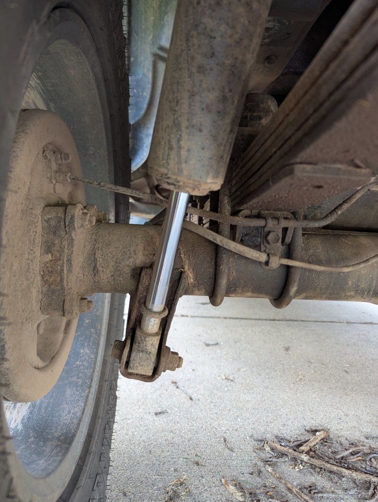

    I just got done with a vacation that had some off roading in it. I did a bunch of low/no maintenance roads at high speeds (45-55mph) and the shocks are incredible. It takes some really big washboards before you notice how bad the road is. So many pot holes, washboards, and puddles I hit at speed. They feel like the faster you go the better the ride gets.
    I felt like I could drive as fast as I could see, meaning if I could see farther down the road I would have gone even faster. Though I was worrying about my LCA cam tabs hitting all those bumps at speed. Gusseted cam tabs might be in my future.
    And I am still using the suggested settings on the DSA shocks
    I have Perry Parts bumpstops, which help out a ton when you are topping out, I only felt them top out maybe 3 times. Which were some really big hits going through washed out sections of road at 40mph.
    Here is a picture of my rear shock you can see the rubber sweeper (I guess that is what's called) still has some space so the shocks don't top out.
    What I lost is about 1/2" of down travel that the Icon leaf pack would have given me.
    Honestly I am not able to tell I lost a little bit of travel compared to my previous shocks, but I can 100% tell the ride quality difference once you leave the pavement.

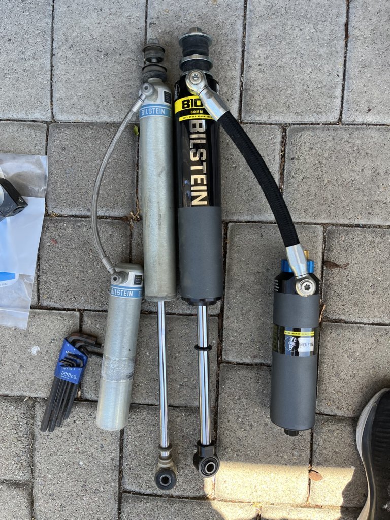

    Thanks for the update! I’m just getting to the install. Overall it looks like the 8100s are about an inch shorter. Not a huge deal in the grand scheme.

    For me when I installed the shock top bolt with the leaf pack sitting at max droop the shocks bottom bolt was about a 1/2" short, so depending on your leaf pack setup you might not even loose the full inch.
    I could see maybe if your kinda off roading is mainly crawling over obstacles where every little bit of articulation counts having a stock length shock would be a hinderance.
