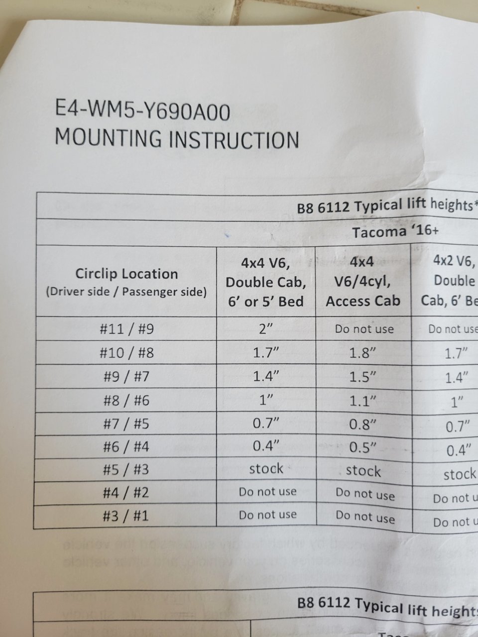

    I'd to get 1.5" lift on a 3rd gen Taco with 700 pound springs with the new Bilstein 6112's (24-309981).
    Does anyone know what the clip setting I should use? Or what you used if with the old model with a 700# spring.

    10/8 so it will settle to 1.5

    Is the answer to your question not in the instructions you uploaded?

    What you are showing is the lift with the 600# springs they come with. My understanding is you will get an extra 0.5" roughly with 650#. I don't know if that translates to another 0.5" with 700# springs. The more variables that change the harder it is to predict. Ask me how I know!
