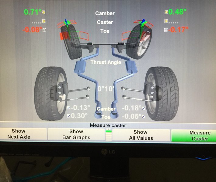

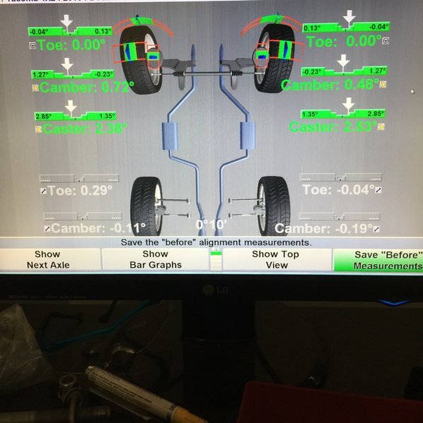

    Dude your alignment guy doesn't know how to align your truck if the wheel is off. Does it drive straight? Differences in caster affect pull. Does the truck pull left or right or is the wheel just clocked off center?
    I just did my alignment last night at work after putting 7500 miles on my truck and the front 2nd gen 6112 springs are fully settled in. My camber and toe were the only things that went off after my initial alignment from the installation. My STRG wheel is perfectly clocked and no pull on flat roads. I have the driver side 1/4" spacer on the top hat and never had an issue with anything being off zero. I only adjusted toe last night, but heading out to El Paso mountains and Trona this weekend, so some stuff will likely get knocked off again. Will fix my camber afterwards.
    Avi, take it to another guy...
    This is what I started with after 7000+ miles on the bilstein..
    As it sits, but will redo it after this weekend.

    why are you set up so positive? dont they say .15?
    Also I prefer neutral

    I was all zeroed out on camber and toe and caster was @2.3 both sides when I first aligned it.
    That setting you're seeing is all worn in with some off road driving. Stuff settles in. You'll have to redo it again regardless.
    I only set my toe last night because I had weird heel toe wear, so I decided to put it on the rack. Didn't have my torque wrench to reset my LCA eccentrics, so I didn't touch caster/ camber. The toe correction will help with tire wear for a few days till next week.
