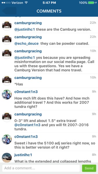

    Camburg is advertising a Bilstein 6112 that has 1.5" longer travel than the "standard" Bilstein 6112. They say it's a "Camburg version". Anybody running these extended travel Camburg 6112's?

    No, that is not what they're saying.
    They're saying they are selling a "Camburg version of the 6112 that has more travel".

    These are direct quotes from Camburg:
    "These are the Camburg version"
    "Yes, we have a Camburg version that has more travel".
    I posted the extended/collapsed/travel numbers for the 6112 and was told by Camburg that "these are the Camburg version which has more travel".

    I don't understand why they're saying they have a "Camburg version that has more travel" when I quoted the 6112 specs. :confused:

    Uhh, are you reading my posts? :crazy: YES THEY DID.

    It's very misleading. :goingcrazy: I'd be all over this "special edition" 6112 if it were true, but I can't seem to find a definite answer. :notsure:

    Any confirmation on this yet? I tried to contact @camburg about this but they never responded. I was hoping my 6112 could be rebuilt at some point and be converted to extended travel and with a heavier spring, ~650lbs.

    I'm pretty sure whoever was running Camburg's Instagram account was just talking out of their ass. :rolleyes:
