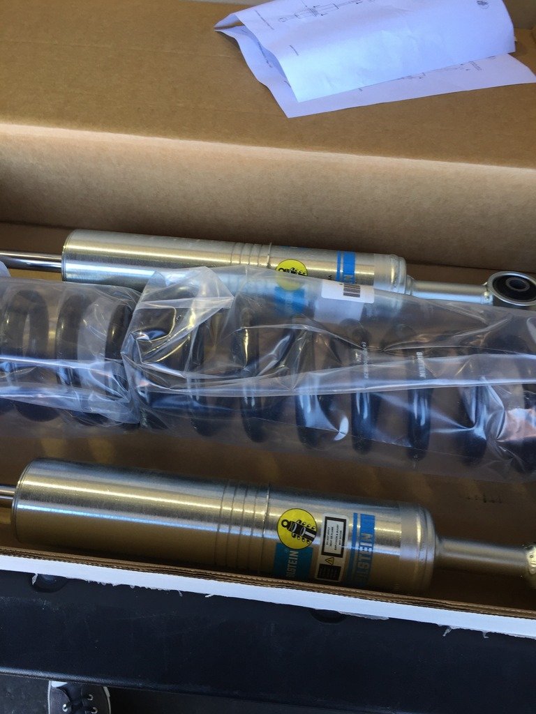

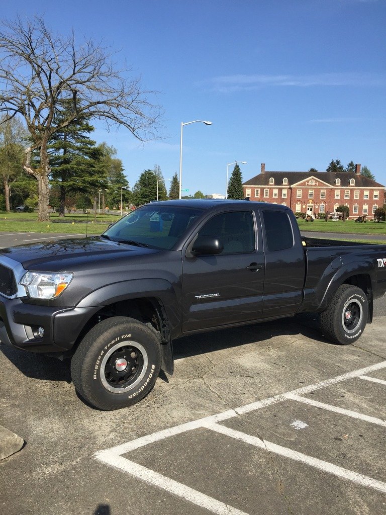

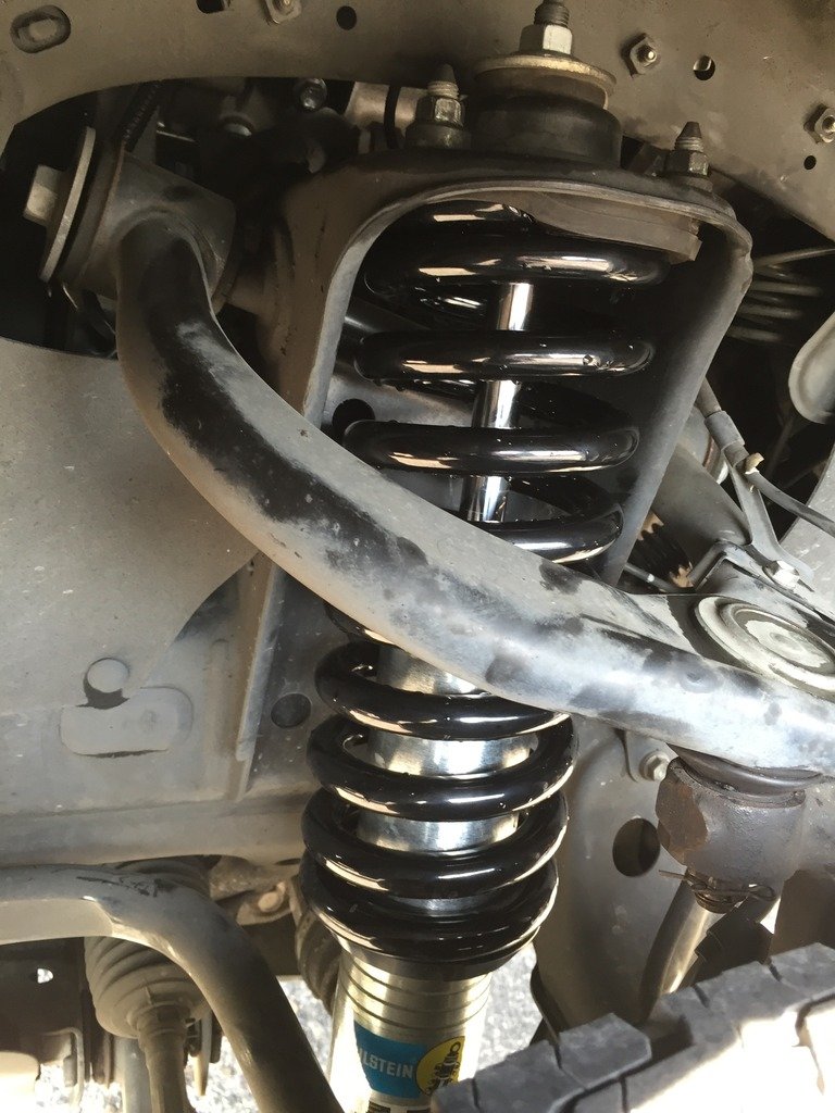

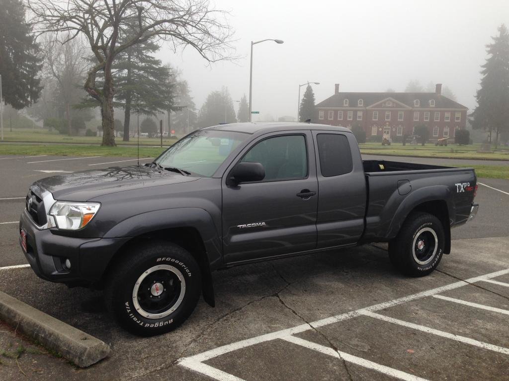

    I received the brand new Bilstein 6112 from Down South MotorSports today and decided to do the install. I didn't document much of the install because of time but for you guys who want to see these on a 4x4, here it is. I measured before starting and got 34 1/4 Inches from the floor of the shop to the left fender centered on the hub. I measured 34 5/8 on the right fender. The results, left side 37 Inches, the right side 37 1/2 Inches. That means I got 2.75 Inches of lift on the driver side and 2.87 Inches of lift on the passenger side. I realize these numbers may "settle" a bit but thats what I got. I also used the top ring, #5 for max lift.
    Before
    After
    Overall I'm very happy with the ride. I will be getting an alignment done at my next oil change(sometime this month). Oh and Down South MotorSports was great to buy from, really fast shipping too and cheaper than anyone else!
