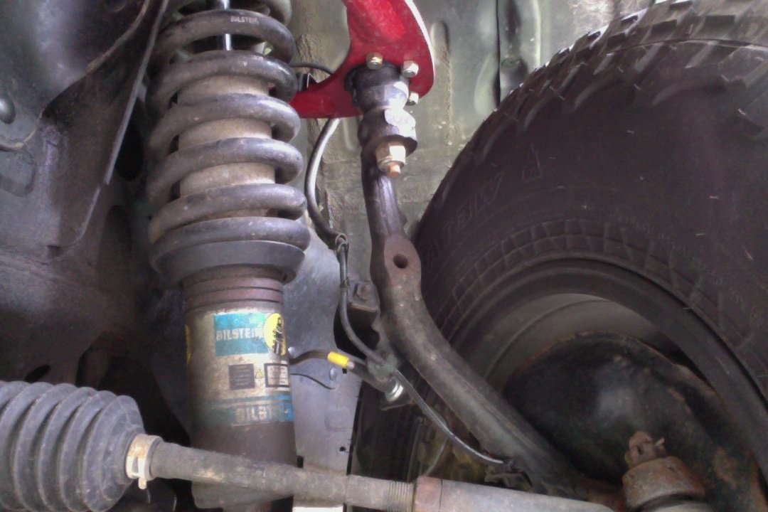

  17. Jul 21, 2017 at 12:17 PM
    #17
    DrFunker
    DrFunker Well-Known Member
    Feb 3, 2014
    #122158
    42,909
    My drivers side:

  19. Jul 21, 2017 at 12:18 PM
    #19
    Unchained 5150
    Unchained 5150 Rick
    Sep 25, 2014
    #139054
    65,355
    Rick
    Auburn Ma
    2021 TRD Poser Pro Manual.
    Gotta love the Winters up here huh Doc, those shock assemblies look 5 years old already

  20. Jul 21, 2017 at 12:22 PM
    #20
    DrFunker
    Feb 3, 2014
    #122158
    42,909
    No shit! That and hosing them down with FF makes them look like shit too. :D
