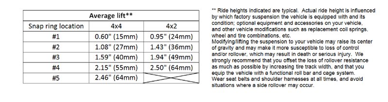

    For those of you running 285s with this set of COs, are you using a top plate spacer to achieve enough lift or will the 2.5" setting achieve it with stock bumper? I'm going to be removing my current setup and I'll take pre-measurements to verify where I'm at currently. Hopefully I can obtain similar lift with this setup so I don't have to trim much more than I have, currently.

    I received my 6112 kit today. Beefy shocks, can't wait to get them on to see how they ride. Wish there was a bit more info out there on what lift height to expect on the 4th or 5th setting with a DCSB. I'm wondering if I can get by with the 4th setting and 1/4" top plate on the passenger side, and 3/8" top plate on the driver's side... and still fit my 285s. Might try it, but it just might cost me two builds to know for sure!

    You guys are doing great, tho I must say that you haven't provided me with any info that CarID and an internet search hasnt. I've already seen the lift chart and found a few guys who have actually installed these to get some feedback on actual lift. At any rate, I plan to do mine next week and I'll give the measurements when I'm done... And won't charge a consultation fee to anyone who is interested in the data.
