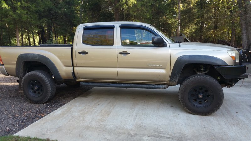

    I'm not back 100" because I would be at 3" but I'm roughly close. It's still a heavy bumper setup. To me it rides the same as 600lb coils. I posted a picture of how it sets

    Looks good! I assume you have the new springs on the 4th notch as you did with the old ones?

    Yea.. only thing changed was the coil spring
