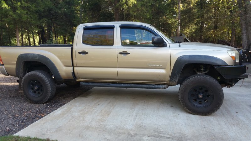

    I have mine maxed out.. my arb is the heaves on the market. I still need height lol. I got allpro full leaf packs in the rear.

    This is how mine is setting right now.. but just a hair lower in the front after the springs settled
