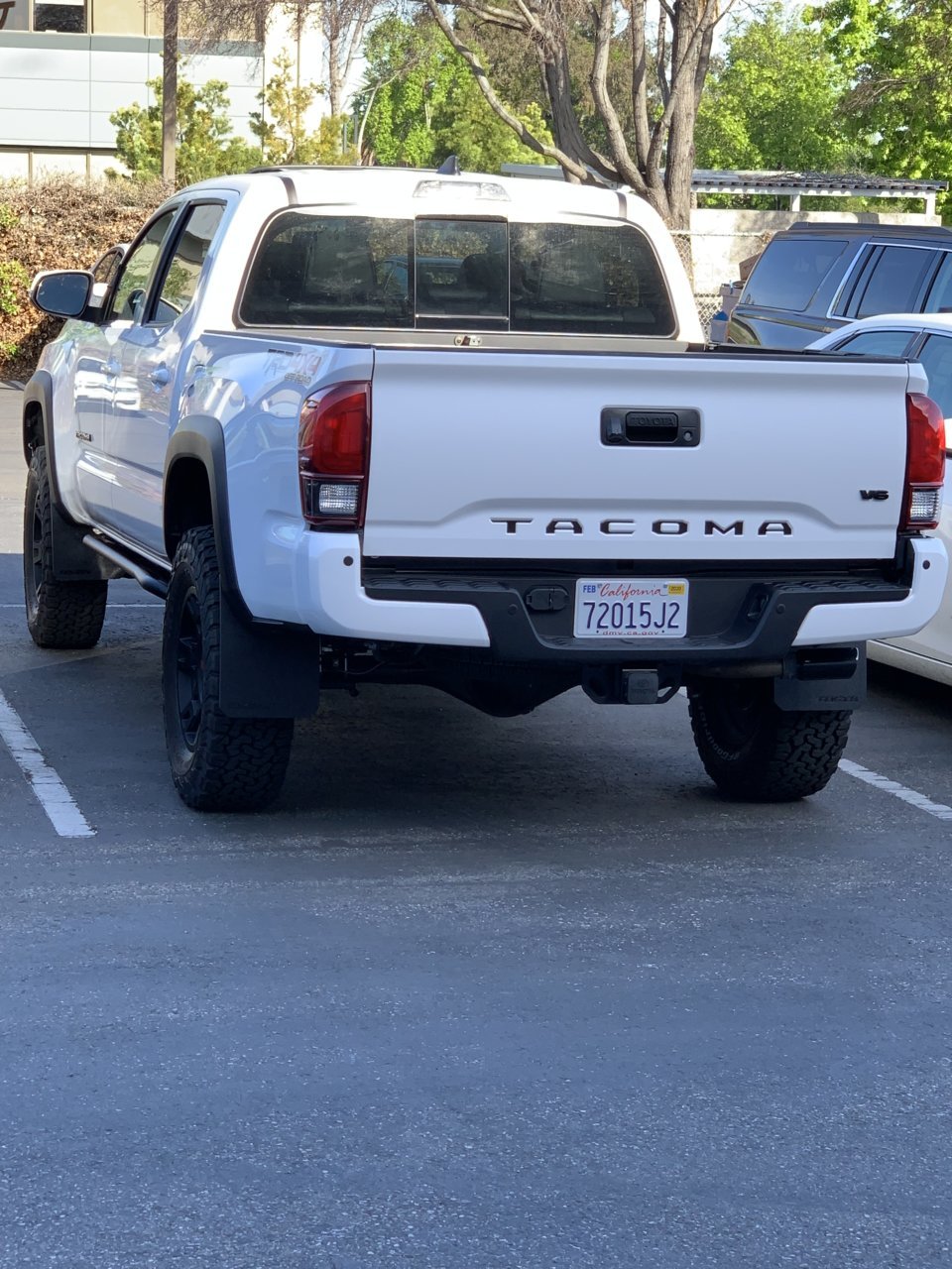

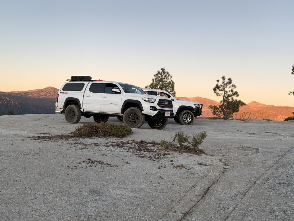

    I would definitely recommend the AAL for the lift, firmer ride, and also for handling weight in the bed without bottoming out on the highway. (Some will recommend a full leaf pack, but I have had no issue with AAL on two trucks now.) UCA is recommended for correct caster which does help steering feel on the highway. But, you may or may not notice a difference, so use your own judgment.
    Pics of lift: (running 275/70/17 tires)

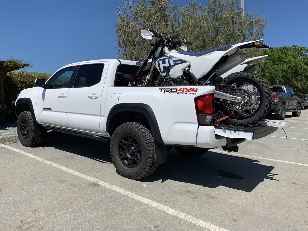

    Nice bike! I have the 501 (Same year)
    Tacoma and Husqvarna guy, I like you
