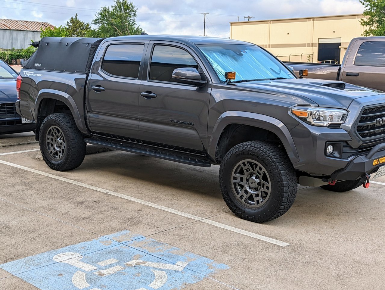

    I just got mine off of bilsteinlifts a few weeks ago.
    Tires will fit fine. And I really enjoy the performance. It's a great shock for highway and light to moderate trails.
    This is 265/70/17 tires with the front on the 4th/3rd perch, rear lifted 1.75 with icon AAL.

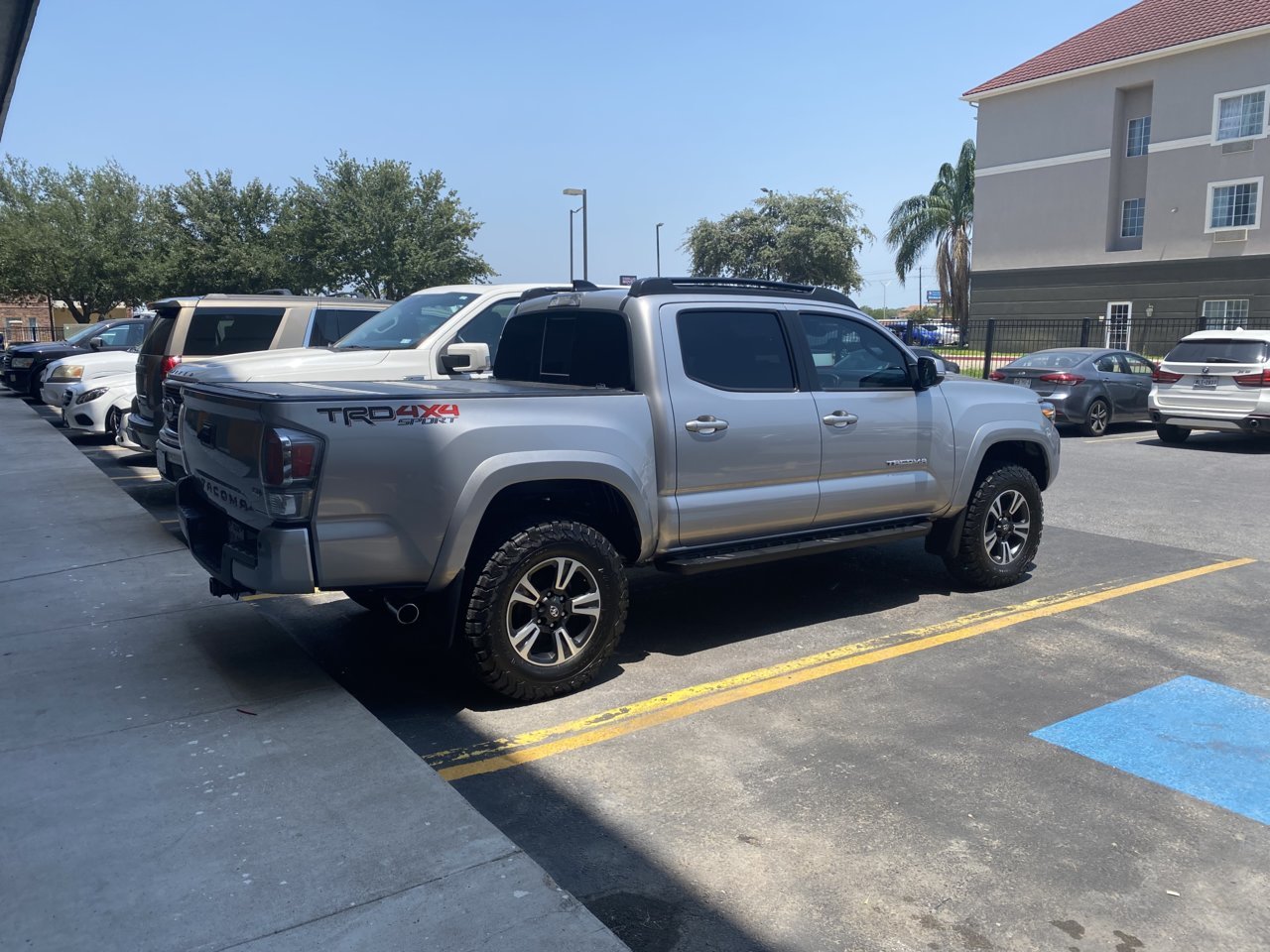

    6112’s at 1.75” front with 265/70/17 KO2’s in C load. Ride is excellent on and off road. I’m on stock UCA’s and it aligned with flying colors.

    Looks good! You only upgraded the front and left the back stock correct?

    1.5 rear blocks on stock shocks. I’ll eventually install a nice AAL but for now the priority is to change out the rear Hitachis for some 5160’s. I got the 6112’s with low miles in exchange for my stock struts + 2” lift spacer.
