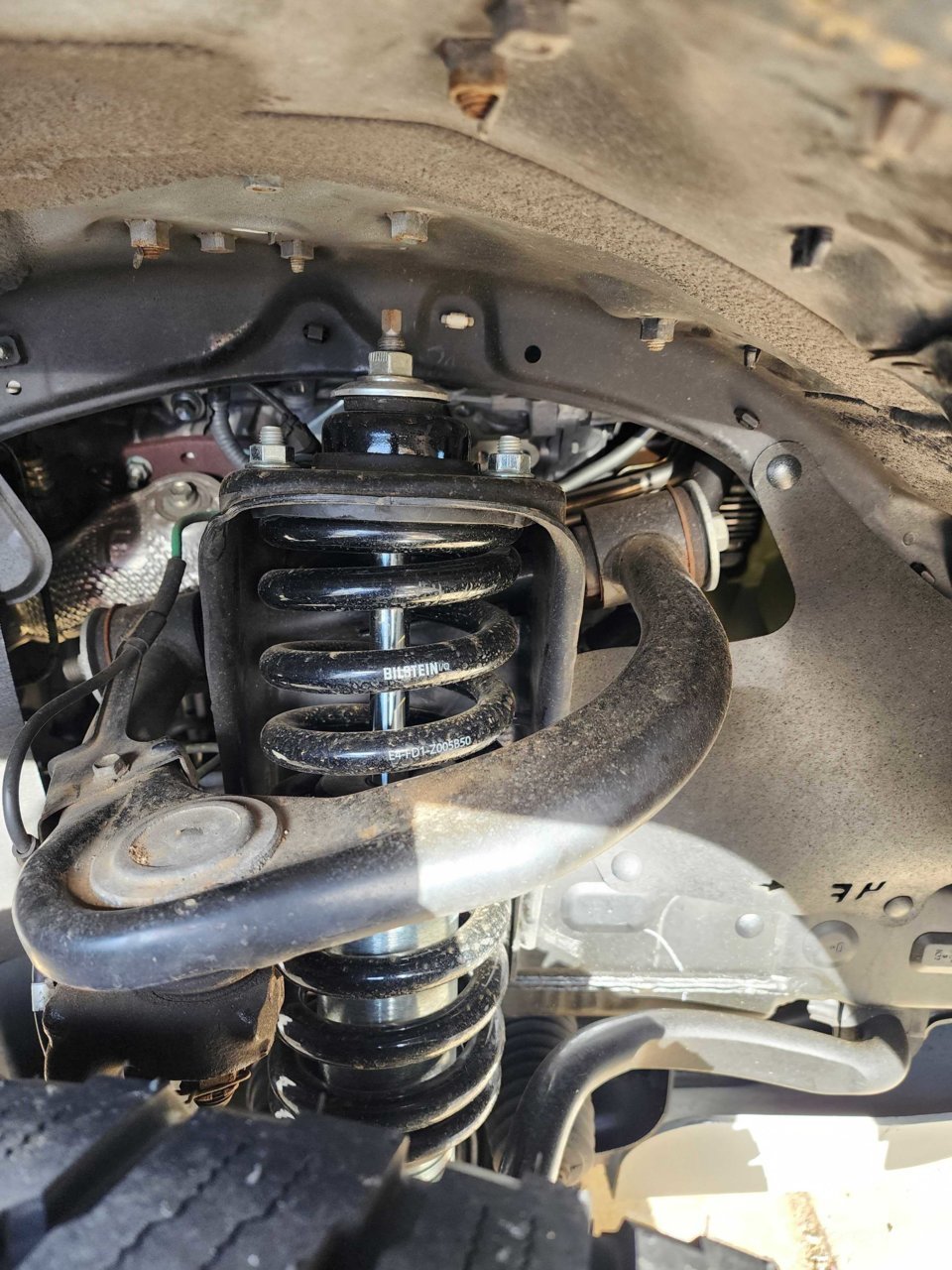

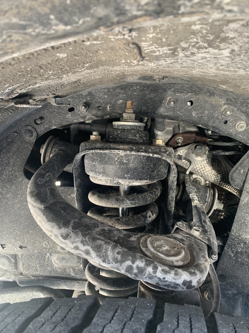

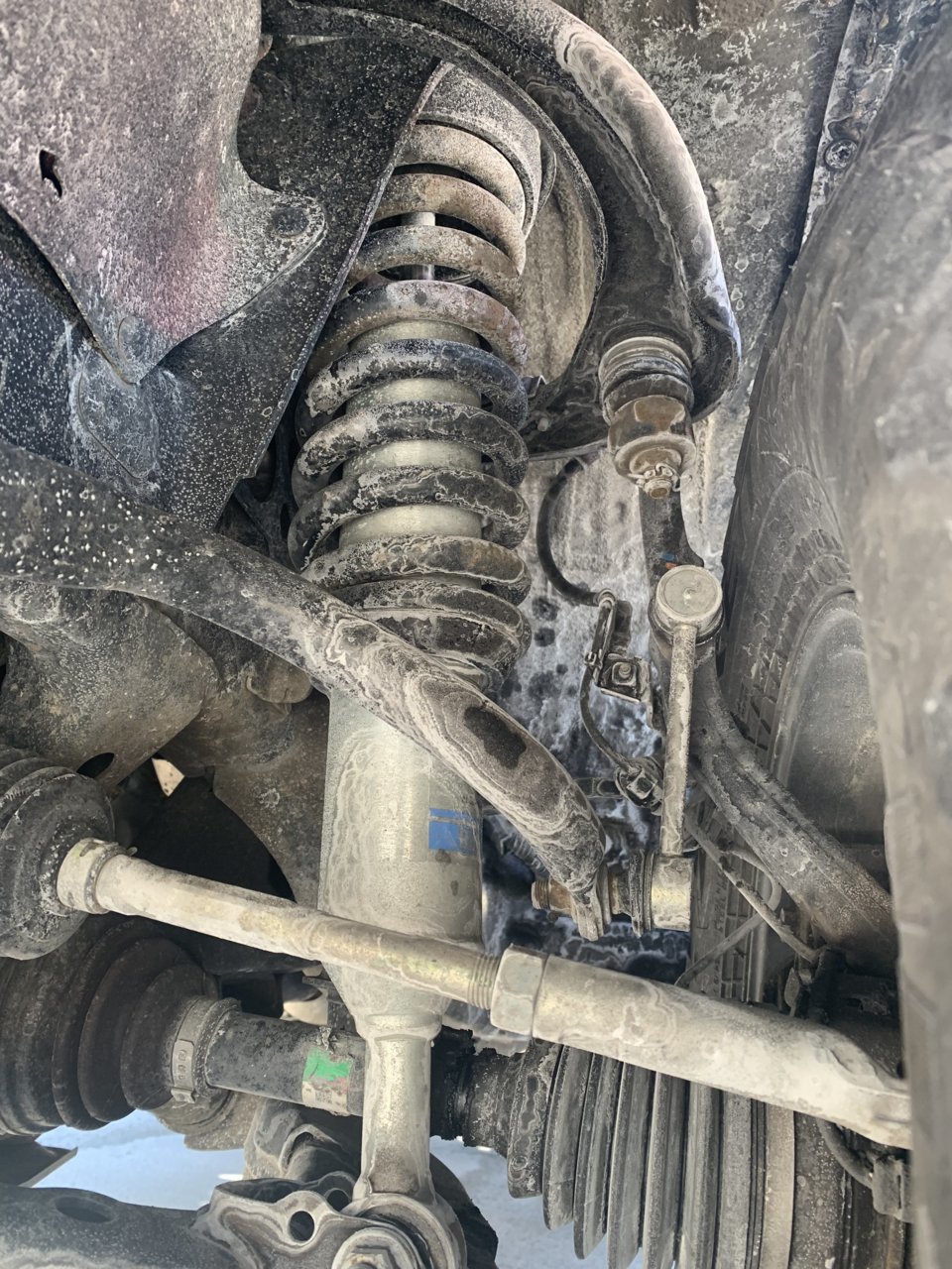

    We need photos to help.
    Ready lift is usually spacer leveling kits, so blocks. So take a picture of the top of the shock, and the body of the shock.
    Then we can help!

    2018 Tacoma Offroad

    Here are some photos for reference
    The photos of the suspension are at current levels (both sides are at the 2nd ring on the strut). The photo of the truck during the summer is at current level, photo of truck in snow was from before I had the struts lowered.
