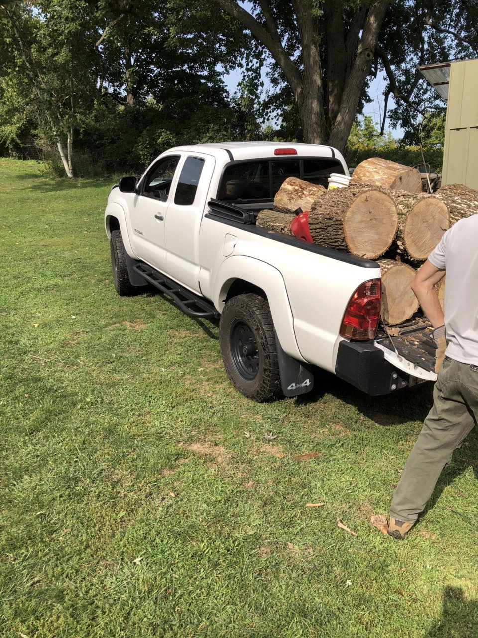

    CB drop shim . No shims under leafs . I have maybe 100 pounds in the bed at all times but I have a camper Ipull a few times a year . Also use the bed for getting firewood. I have a slight vibration if I take off too quickly other than that I’m good .

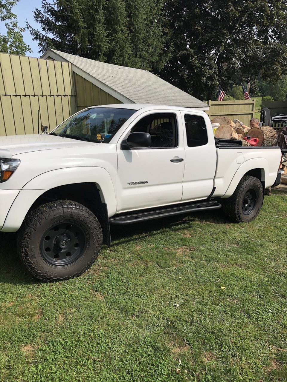

    This is me now. 6112 top notch… might want to lower it. 5160 rears with HD Dakar. Still squatting also, drive shaft vibes even with the spacers dropping the CB.
