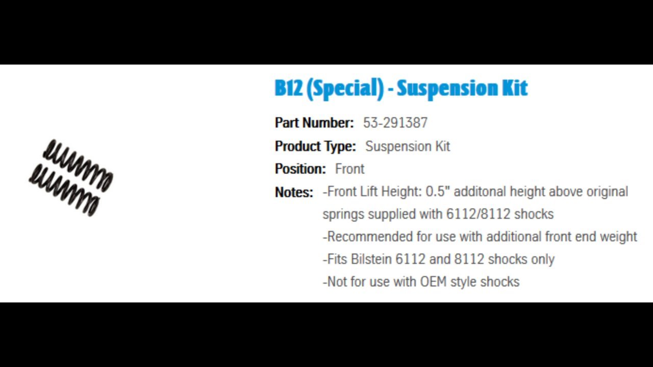

    After hours of scouring and dreading i wasted money on a 6112/5160 set, this is what i need. I have a honey badger bumper and a winch in the basement and have been told it's too much weight (300lbs?). These coil options will save my arse so i can throw everything on the truck now, correct?

    The 650s will help, but I would ask wheelers if the 700# springs will work. 700 would be better for that load.

    So I just installed Lil B bumper and 12k winch. I have the standard 6112 (600# coil). Set at 6th drivers set 5th clip passenger. The bumper/winch combo is around 200 lbs. I haven't measured but obviously I’m sagging. Should I go #650 or #700 and at what clip settings? (Guessing game I know). Id like 2.5” of lift.

    6112s CAN use other spring weights. Bilstein actually makes a 650 for them. Dont know why people are saying you're stuck with 600 o_O

    I know. I tried ordered the 650 Bilstein ones. Here in Canada it’s a “special order” 6 week lead time.
    I’m going to order Eibach ones. Just not sure if I should go with #650/#700. ‍♂️

    I debated for a while. I decided to go with 700 when I do order and lower the notch to like 1 or 2. So I can maintain lift height but still not have issues with the extra weight

    Assuming your a v6 4x4? 2.5” of lift is a stretch with 3rd gen 6112s, even if you put a 700lb spring with your bumper and winch. You’d probably just be at 2” up front or just a tad over. They’re only rated for 2” max at 6/5 setting. Eibach 650 and 700 are both 14” in length and I’m 99% sure it’s the same for “bilstein” branded but most likely rebranded eibachs lol.
    I had 650 on my 6112s at 6/5 with 60lbs up front and had about 2 1/8” of lift up front.

    Sounds like #700 6th/5th notch
