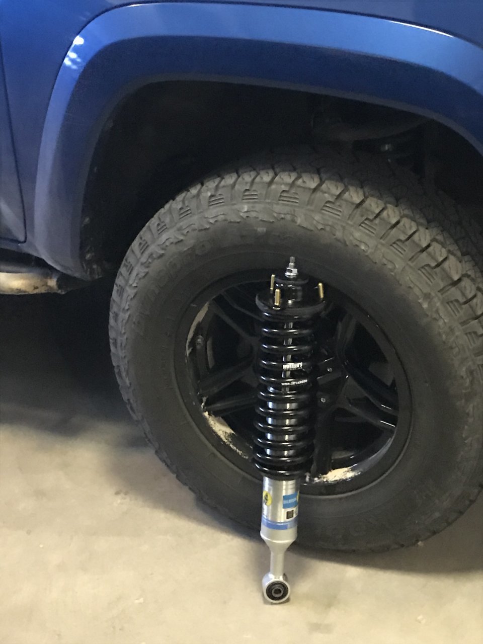

    Not everybody lives here but I am really glad I put a few miles on these springs before heading to the alignment shop. After playing in the sand, the front has dropped over an inch. This photo was right after I installed the 6112 combo.
