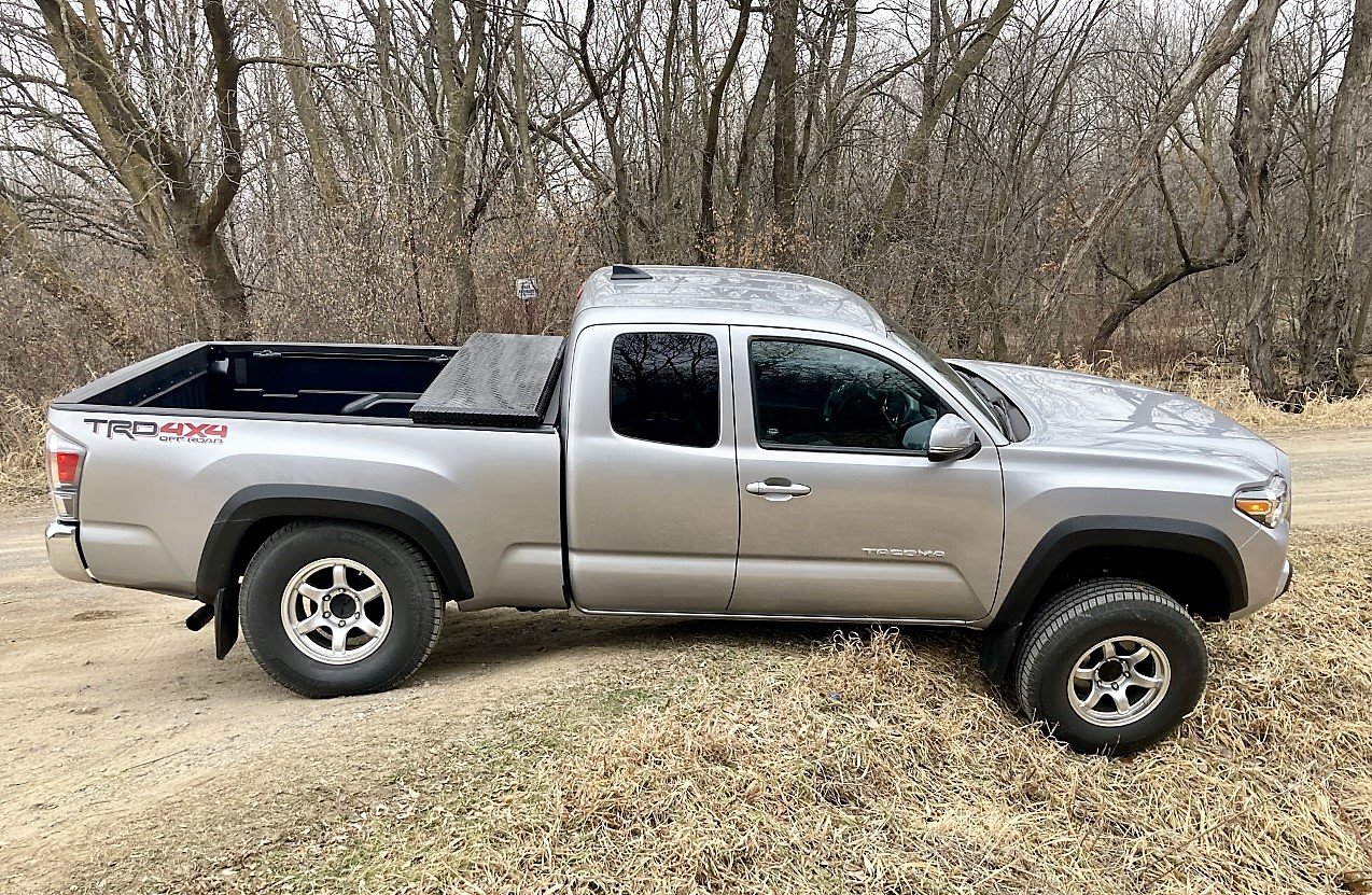

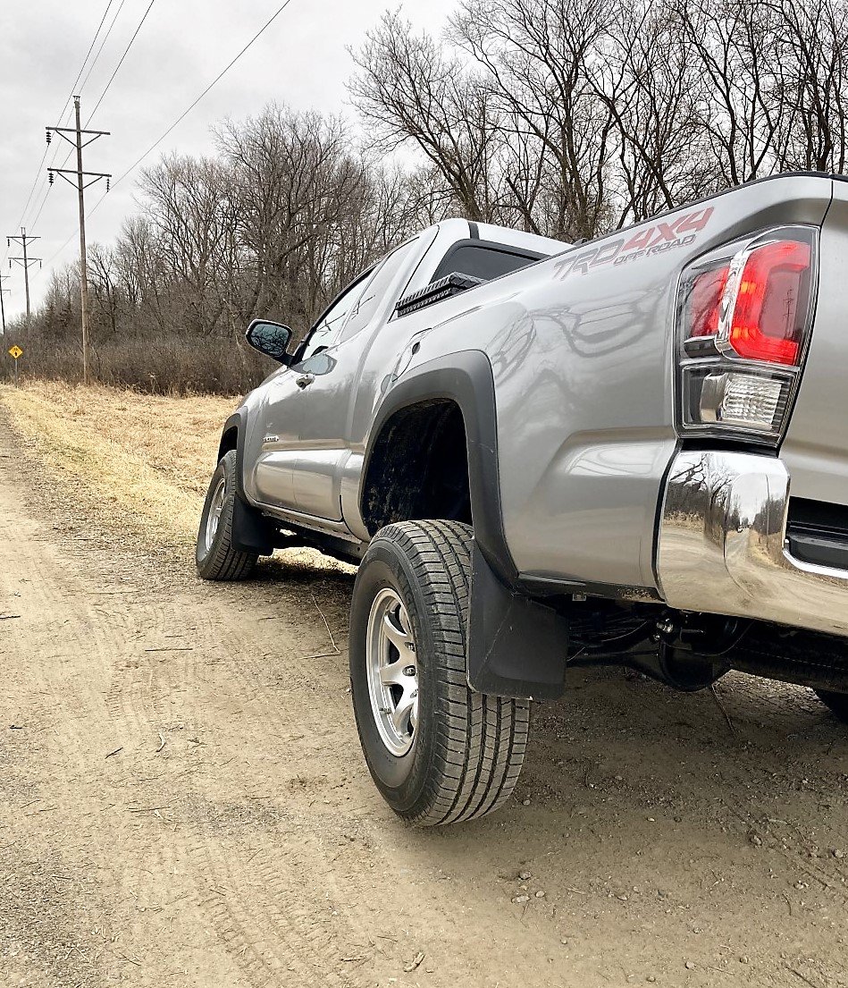

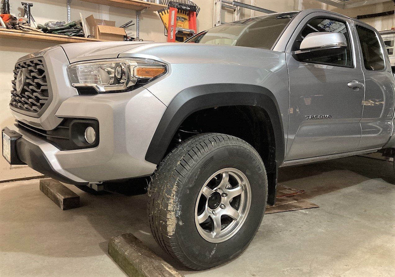

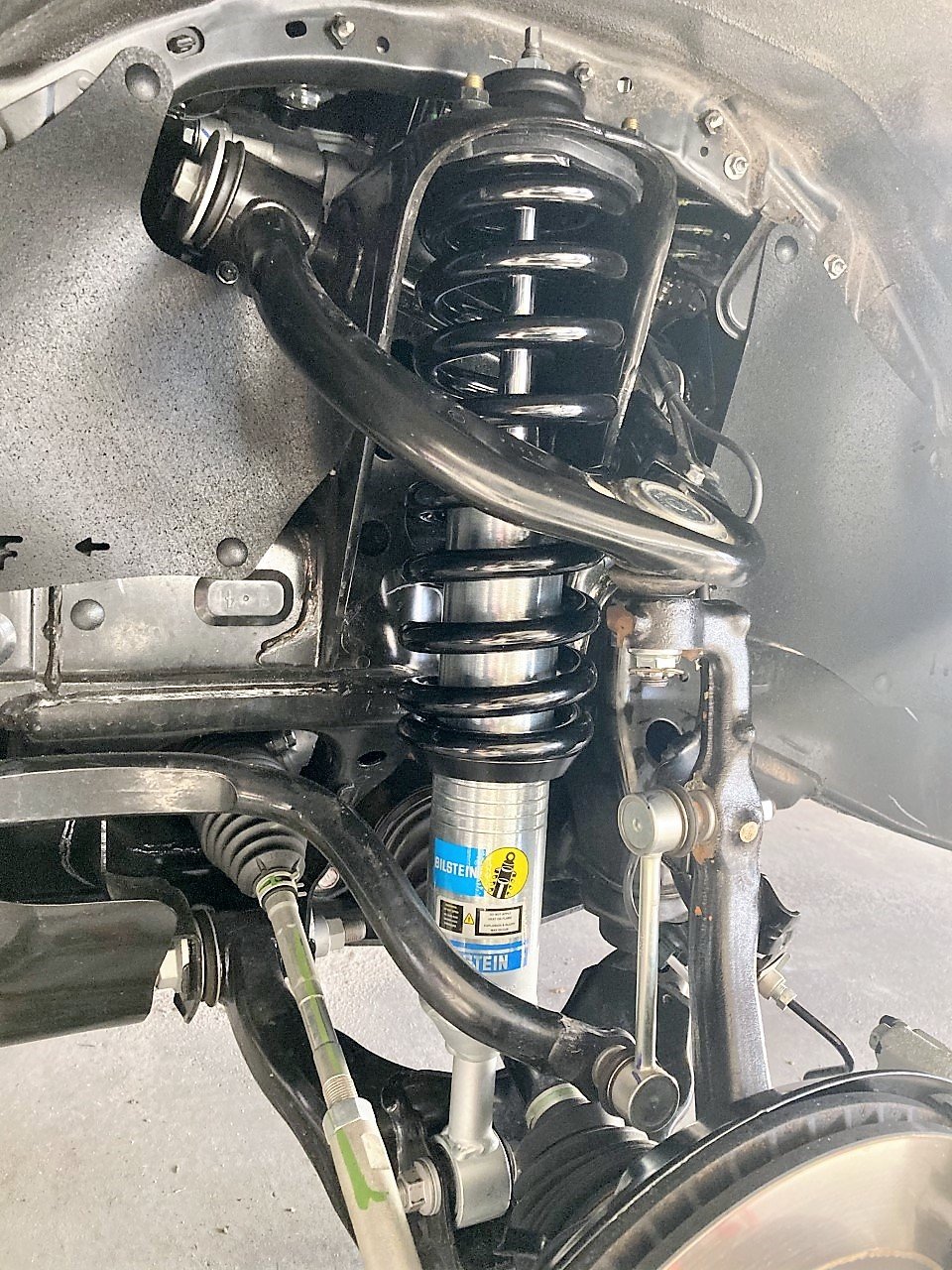

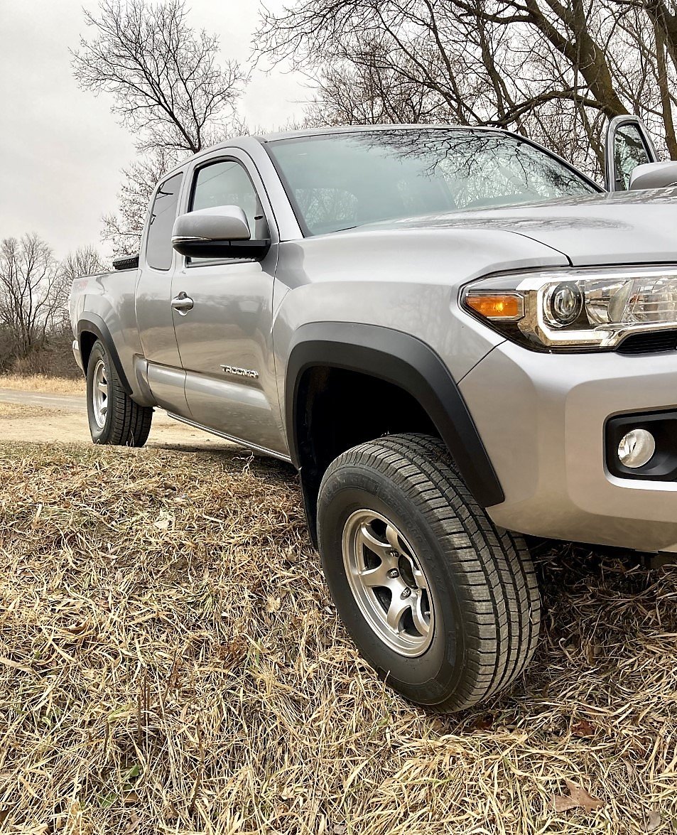

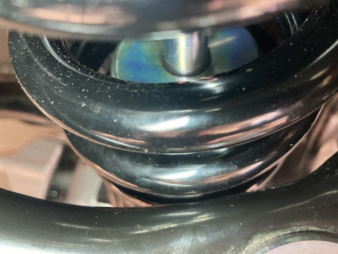

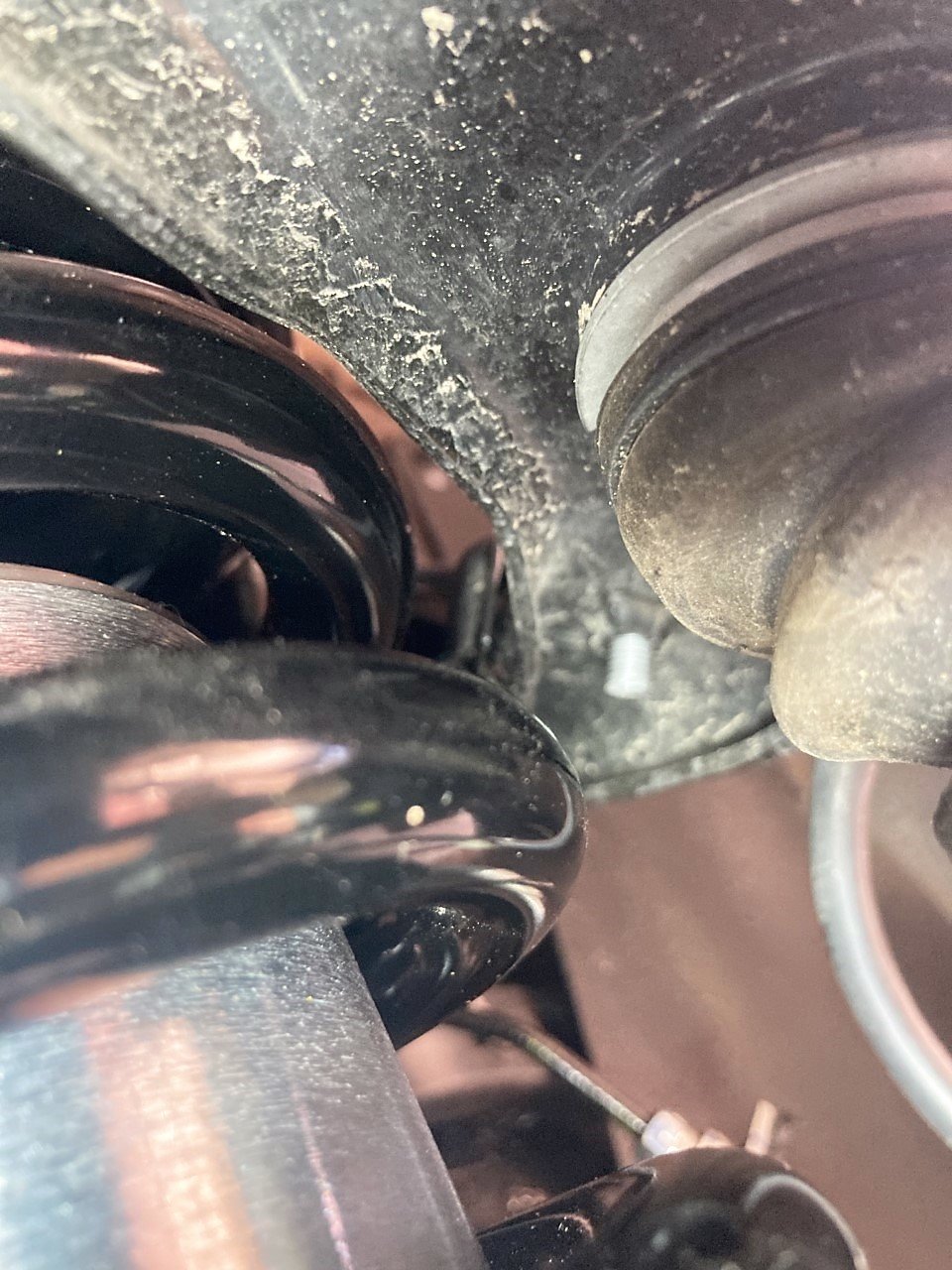

    Received my Bilstein 6112 front coil overs set on 4th and 5th clip for the Access Cab. with top hats installed.
    Installed them and upon lowering everything down they were at 23.75". Was worried they might have made a mistake and sent me 650lb springs. Took a pic of the numbers on the spring..
    Seems Bilstein designed these coil overs better than I anticipated.
    Some measurements I took of the assembled coil overs off the truck:
    TRD O/R top hat to center of bottom bolt hole 21 5/8"
    TRD O/R with 1" spacer 22 5/8"
    Bilstein 6112 22 3/8"
    On full droop, the TRD O/R with 1" spacer ~ stock upper control arm WILL make contact with the coil
    On full droop, with the Bilstein 6112 (4th/5th clip Access Cab) ~ stock Upper control arm DOES not hit coil
    I took the truck out and went over some higher 6-7" curbs (slowly < 5mph) to give them some exercise.
    First thought.. I was extremely surprised how they minimized the impact to almost nothing. The curb impacts reminded me of rocky terrain that you encounter in the San Juans of CO.
    Feel really good about the purchase right off the bat. Nothing at all like the impact of stock TRD O/R coil overs.
    Didn't have enough time for further testing but after a dozen or so curb impacts,
    I measured again at 22.75" (dropped 1" from install)
    Rear 5160s should be here next week. Haven't decided what I will do with rear lift yet. I haul my dirt bikes in the back alot and may pick up a Leer 122 shell for ultra-light camping. Once I decide on the shell I'll focus on rear lift and method I'll use.
    I'm running my old Konig (FN) Countersteers 16x8 zero offset (16.5 lbs) with Michelin LTX Defenders 265/75-16 for pavement pounding (56 lbs and 4lbs less than stock). Will be fitting 255 17s ATs with Konig (FN) Sixshooters when stock arrives. I'll powerdercoat the 16s eventually in a different color and have multiple wheels sets, each for different purposes.
    I was all set to plop down $4500 for an adjustable full on FOX set up.. but I decided against it since I live in the upper midwest and winter salt is severe here. My 00 Taco was bought back by Toyota due to frame rail rust and my 06 faced the same problem. Every fastener underneath both the 00 and 06 was completely rusted to the point of "unremovable without a torch or a 3' breaker bar". Couldn't see an expensive Fox system getting tortured by salt.
    Few pics
