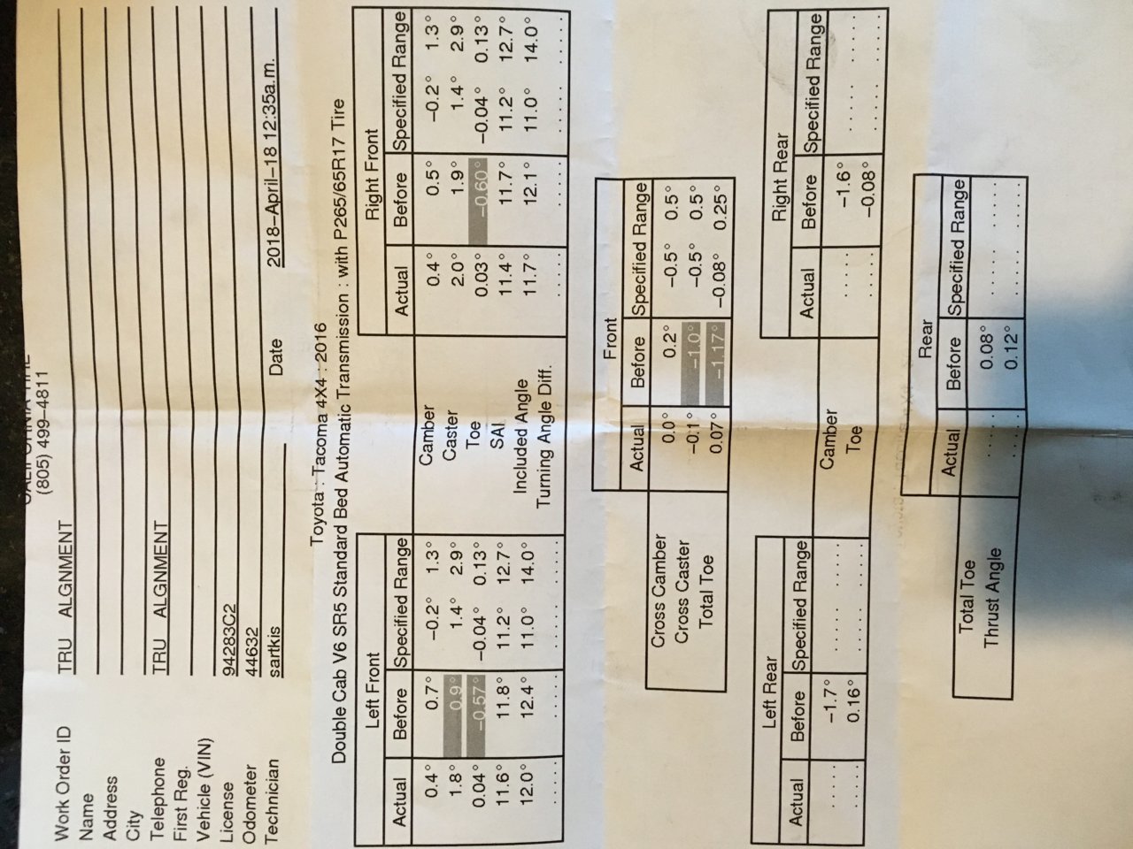

    Thats not the point. You probably have less then ideal caster numbers, probably have UCA close / hitting coils and are probably close to full extension of the stock upper ball joint at droop.

    I know, that’s why I got the total chaos. The UCA replacement is a PITA and I didn’t wanna deal with it the other day. I’ll get around to it. But honestly do the numbers look that bad?

    nope numbers arent bad at all actually. As long as she drives decent you should be good. My only concern would be topping out of the ball joint / uca hitting coil.

    There is a country mile in between the coil over and the UCA if you look at my second post pictures u see it at full extension. We are talking inches. Rides like a dream. But I agree UCA's are going on, but lets stop lying to ourself's and admit, its purely for style. Which ofcoarse Im good with. I got all the total chaos stuff including the weld on strut gusseting... lol For me its all about a zombie apocalypse, but truth be told, this offload addition is a pretty capable truck right from the get go, everything else was cause I could..

    the setup is dope OP. If the alignment numbers are well within limits and for what you use your truck for, it’s all good. Can’t wait to see the progress!
