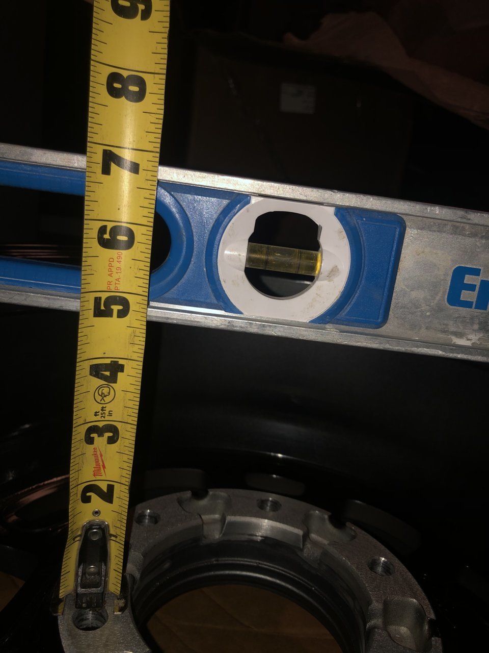

    Well I got an idea and that is I measured my wheel and it’s 4 5/8 which is only 1/8 of a difference considering the maximum with of the tire is 285 on 4.5 backspace So I did some math and 1/8 is 3.175 mm so the tire that I want is 265 (mm) and the maximum on the 4.5 backspace is (285) difference in that is 20 (mm) so I believe I got 16.825 (mm) wiggle room and then I got to consider the flex on the the wheel rear wheels when I go off-roading which I don’t how far the tire/wheel flexes

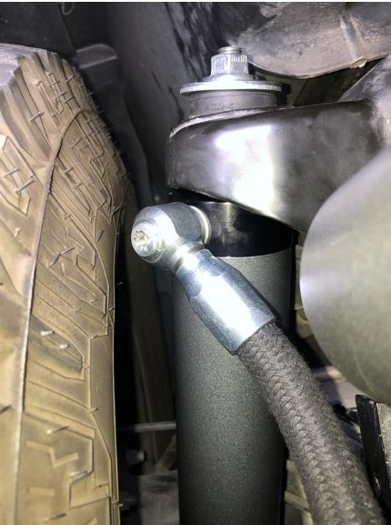

    More info from Bilstein (pic is theirs):
    "...the bigger concern is the banjo fitting on the smooth body shock. When testing clearance’s with a stock wheels and 265/75/16 it came 3mm away from contacting the banjo with the tire fully articulated (photo below) the reservoir on the bypass is not in the same location so the concern was not there."
    So that explains the clearance concern, and the difference between the smooth vs bypass. I'll update when I get mine installed.

    Ahhh okay. That makes more sense. Thank you for posting. If I do end up going with these shocks I'll probably put proper hubcentric wheel spacers on for peace of mind since I prefer sticking with OEM wheels and a little poke would look good anyway.

    Wow that looks close

    Well I’m going to try it out since I believe it would work my wheel is literally 1/8 off from there 4.5 backspace recommendation so my wheels backspace is 4.64 which is not too bad but just in case it don’t work out I decided to add wheel spacers but only on the rear and it’s only going to be 1/4 inch spacers if it don’t look right then I’m going to add the front as well…..Also since I already ordered the 8100 smooth body shocks I’m not going install them just yet I will provide a pic on my truck for comparison on existing wheel/tire
