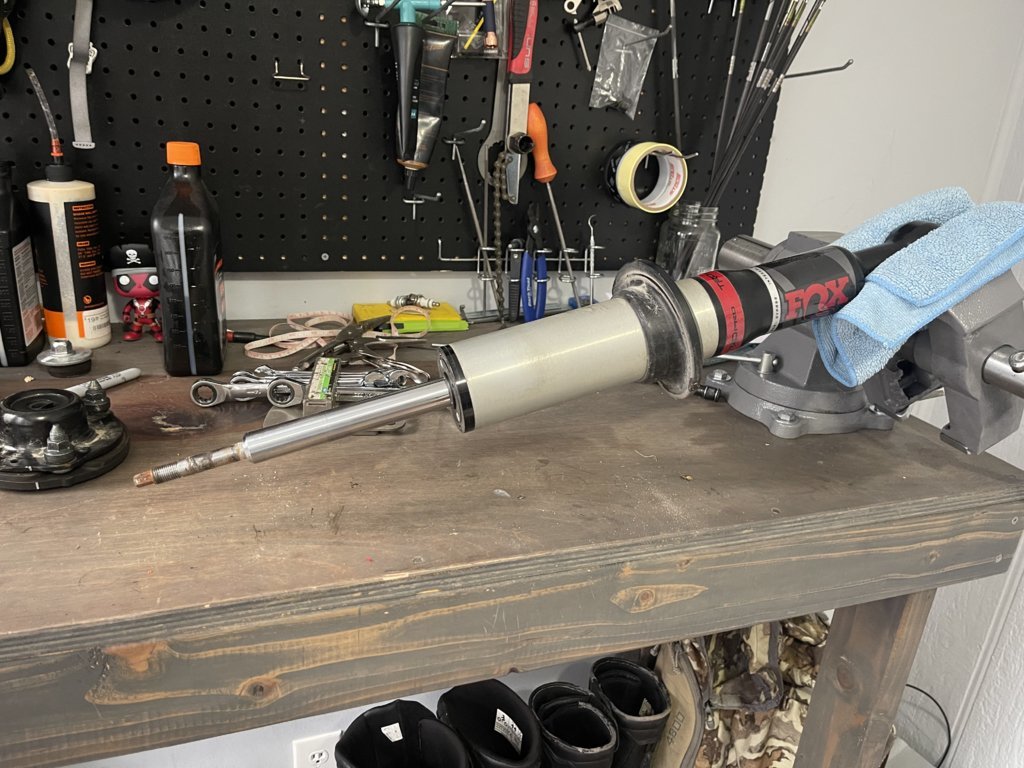

    Another update. I got my drivers side warranty strut from Hotshot (again, incredibly fast shipping). Though, while I wait for Mudify (yes, STILL waiting) I decided to get my hands on a used/new set of Westcott preload collars for the Fox struts; really to just have a backup set of struts whenever suspension services are due but also to see if by running them gets rid of the noise. Well, I installed the collars and put the Fox struts back in with a 1/4” shim instead of Westcotts 1/2” for 2.5” lift total and the noises are gone, it rides like a dream.
    Also, Westcott says this kit isn’t a spacer lift but, the preload collar only adds a half inch of lift and the other 1” comes from a shim/spacer. Just thought that was hilarious, kind of a money grab I think but whatev. I’m stoked the noises are gone. Hopefully whenever/if I get the other strut from Mudify and get those installed there won’t be any more clunks cause I really want to like those 8112s!
