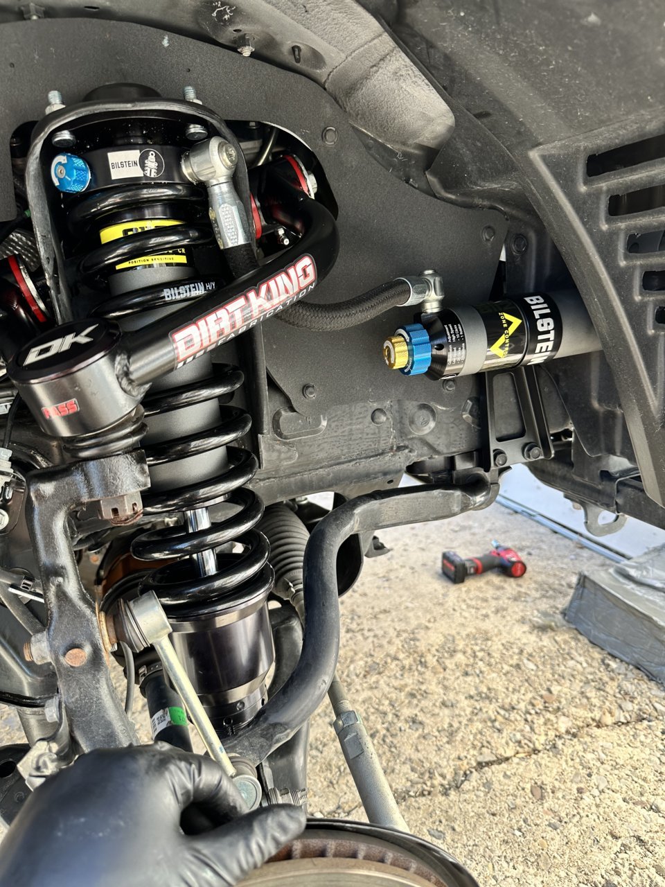

    I got my 8112 installed . I use to have the 6112 trd Bilstein kit for the front and rear .
    Front shocks has a mid travel camburg system . I want to pair the back with tje 8100 but don’t know if by pass body or non. And the rxt leaf park or do the under leaf package from camburg

  5. Oct 4, 2024 at 5:26 AM
    #205
    Wero94
    Wero94 Well-Known Member
    Sep 29, 2016
    #198594
    65
    2016 tacoma trd Sport double cab
  6. Oct 4, 2024 at 5:29 AM
    #206
    memario1214
    memario1214 Hotshot Offroad Moderator Vendor
    Oct 1, 2009
    #23628
    20,196
    Colton
    Missoula, MT
    SOLD - 05 Dub Cab TRD Sport 4x4, CURRENT - '21 Tundra MGM Limited
    Do you have any load carrying capacity needs? Spring under is cool, but your ability to handle load kind of goes to the birds. We’ve had a lot of folks pair 8100s with Icon RXTs with good success. The bypasses are the longest of the bunch so they’ll give you the greatest travel characteristics.
  7. Oct 4, 2024 at 5:33 AM
    #207
    Wero94
    Sep 29, 2016
    #198594
    65
    Usually my trunk it’s empty . The only adding weight would be the rear tyres install and the my rear steel bumper nothing else. Thinking to adding hellwig sway bar for the rear . I love to do around 120km on the highway in Cabo .
