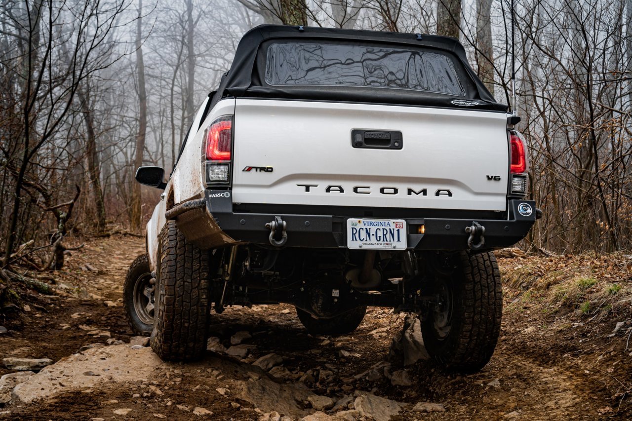

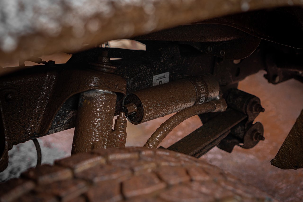

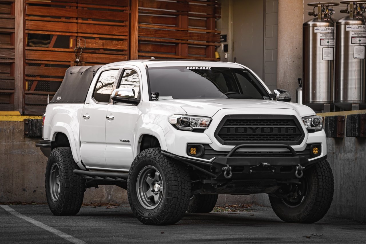

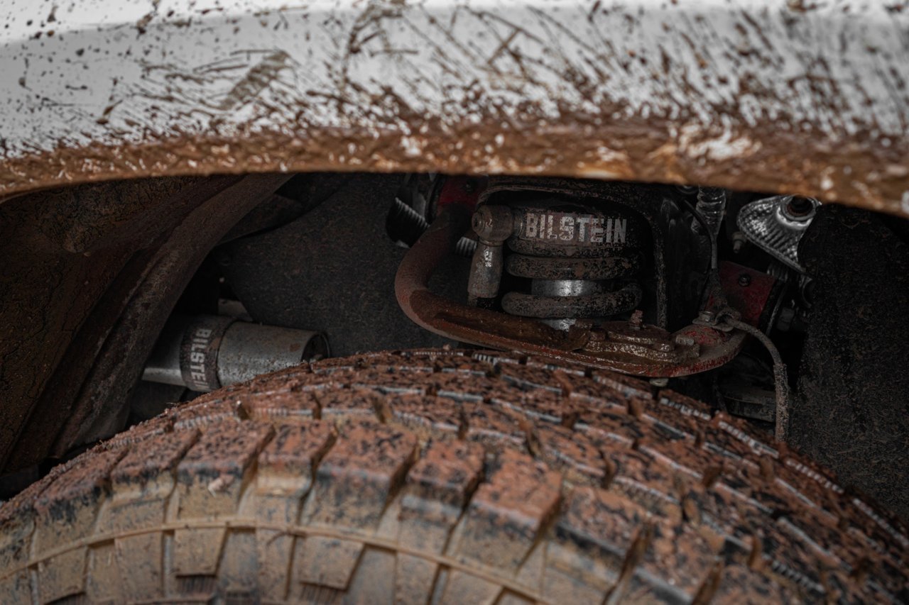

  16. Aug 23, 2020 at 12:51 AM
    #76
    oscolivar1
    oscolivar1 Well-Known Member
    Oct 30, 2013
    #115568
    2,267
    Oliver
    VA
    2017 Tacoma Limited
    Bilstein 8112/8100, JBA UCAs, Icon RXT leaf pack, work wheels 17x8.5;-10os, 285/75/17 cooper LTX AT3, Mobtown HC rear bumper and Sliders, SSO front bumper, BAMF greceased grill.
    The rears do tarnish a bit, the fronts not so much but even Bilstein even said that under their website/instruction I believe. I also did not wash them or rinse them immediately as I usually would have but I’m busy with work etc. It ain’t that serious though, it makes it looks like you use your truck lol. They are not rusting so I dont care, unlike the 5160. They rusted immediately after it saw salt.
    I have 650 lbs spring and and icon RXT option 3 I have 0 complaints yet.....C98FEBD8-77BE-48F3-A5C5-1982D8EE7FE8.jpg 23778724-796C-494D-B781-3E38667F6EAA.jpg E9B976E0-B18E-47FD-8609-3C89B38E32D7.jpgFE16F562-E72D-46B2-B646-E496D2CEE51B.jpg
