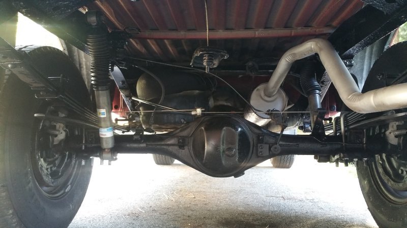

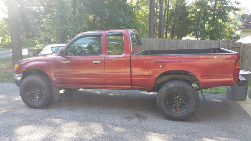

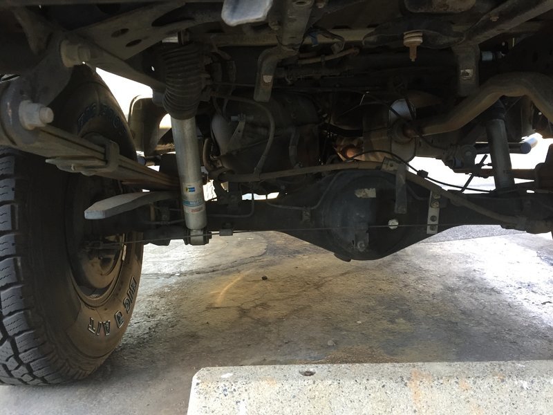

    I put on a headstrong 3 leaf AAL in the back and like it a lot so far. kinda stiff but should settle down a bit. I still have to put on my front billies. Plan on setting them at 2.5 as well. Some pics below (yes I know my rear 5100's are technically upside down).

    I have AAL's in the rear w/ 5100's and have had 0 issues for 3 years now. I installed them when I bought my 1st lift, 3" ToyTec spacer lift, then they stayed on for my 2nd lift Adjustable 5100's w/ 3" Eibachs and finally my 3rd lift up front, Icon Ext. travel coil overs. I never messed with the rear of the truck through all 3 lifts. I also have Camburg UCA's. My Bilsteins are installed the same way as @SOMDTACO and my AAL is right above the overload spring in the photo.
