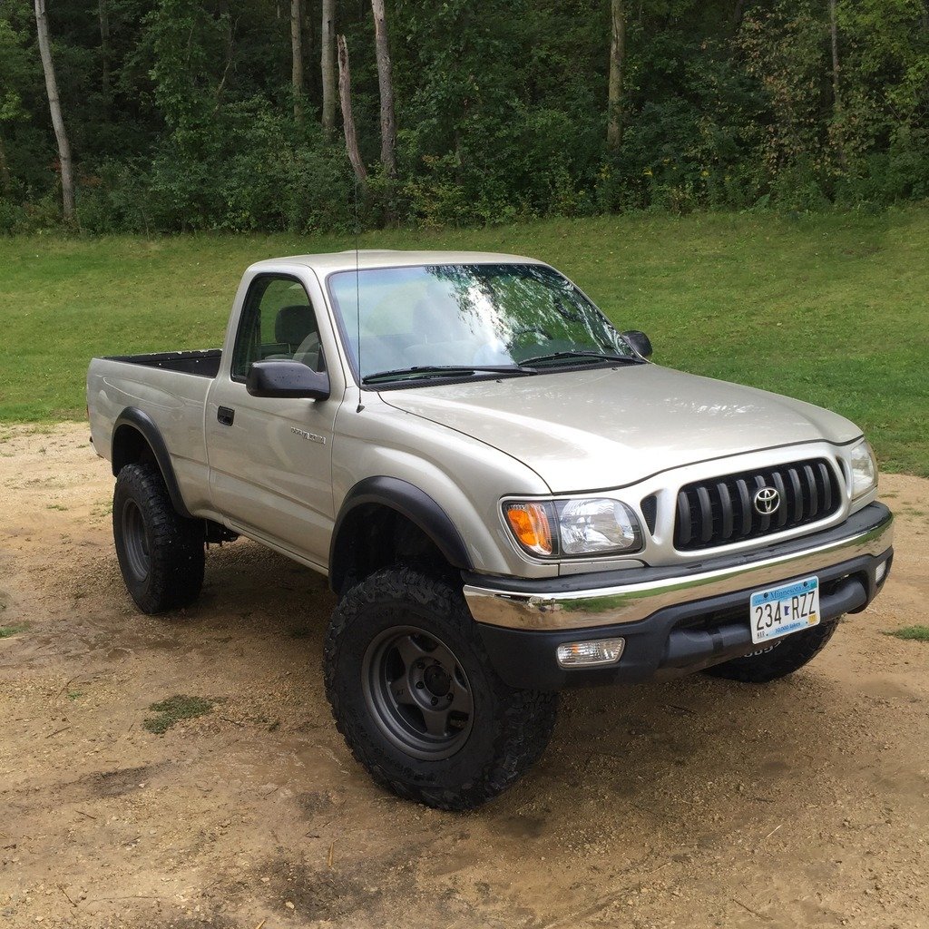

    I used Blistein 5100s, OME 881s and a Wheelers 3 Leaf Progressive AAL. I put 265/75/R16 KO2s on with 3.5" Backspacing. This setup was perfect for me, rides great and was a huge improvement over my 258,000 mile old shocks. It gave me 2"-2.5" of lift (not including extra height from taller tires). Exact dimensions are here.
