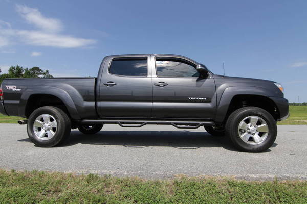

    I just had this exact lift installed last Friday. I got the eibachs already set up on the 2nd notch for about 2.5" lift up front and I got the TSB AAL.
    AAL. I can say is I am very impressed with the stance, ride and how the truck handles now. It may be just a small amount stiffer, maybe it's in my head, but I can really tell a difference. No lean at all speeding through turns, etc,. Mall speed bumps pose no hazards at all now for my prerunner..,, :D
    I haven't gotten it aligned yet due to work, but the mechanic that installed the lift told me ,he didn't think I'd need it, and all is straight and tracking true, so in no hurry. I probably will this coming week.
    Very Happy.
    One note: I was going to get 5100's from DSM, but they don't sell coils mounted on the front shocks so I went with Toytec and happy I did.
    post lift stance:

    you still need to get it aligned, it's not a matter of tracking it's the camber and toe in that need to be adjusted now.
