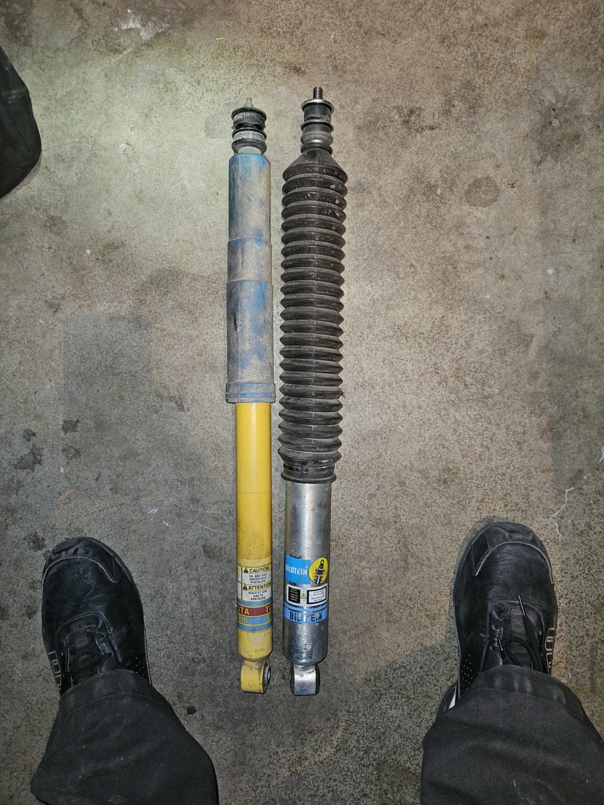

    2016 Offroad stock shocks next to 2023 5100s. Modest upgrade shockwise if they were the same age. Main benefits of 5100 fronts are extended length and ride height preload adjustability.
    If I went back in time, I'd have spent the extra $ and bought also extended, 6112s for the front with the stronger springs to hold up my skid and slider weight rather than using just max preload as I have to with the 5100s.
    In the rear, I already replaced the 5100s with longer Fox 2.0, which also ride smoother, but also about $250 each rather than $100 each.
