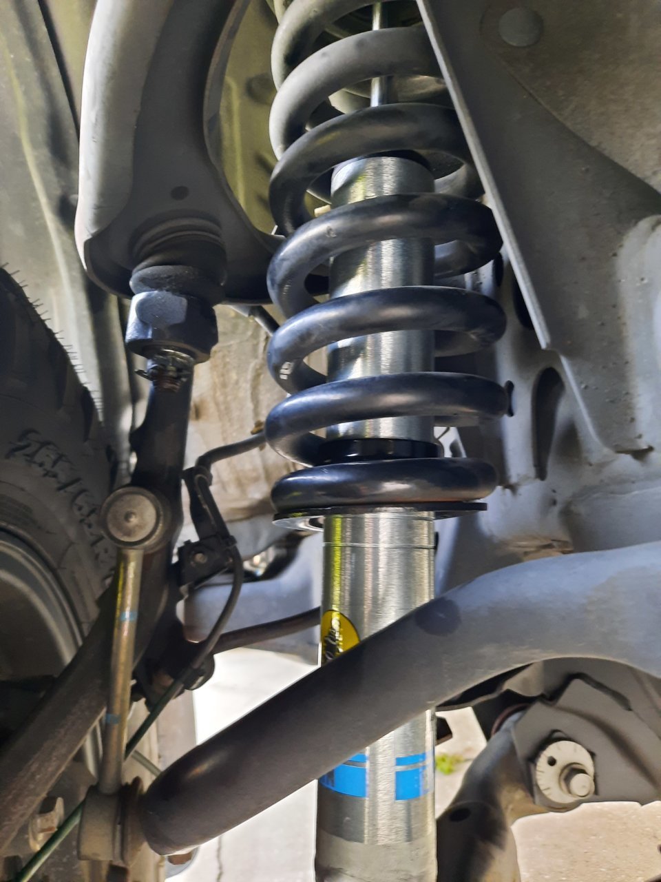

    Front Driver = 24.5in
    Front Pass = 24in
    Rear Driver = 22.5
    Rear Pass = 21

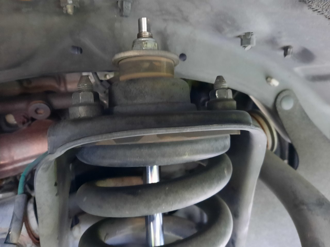

    That's what I thought.. You have ~4.5" of lift on the drivers side. Can post pic of the strut assembly? Coil seats may be upside down. Are these the stock coils?

    Yes the coils are stock, but I didn't do it myself I had it done at Mavis Tire. That doesn't mean it was done right though.

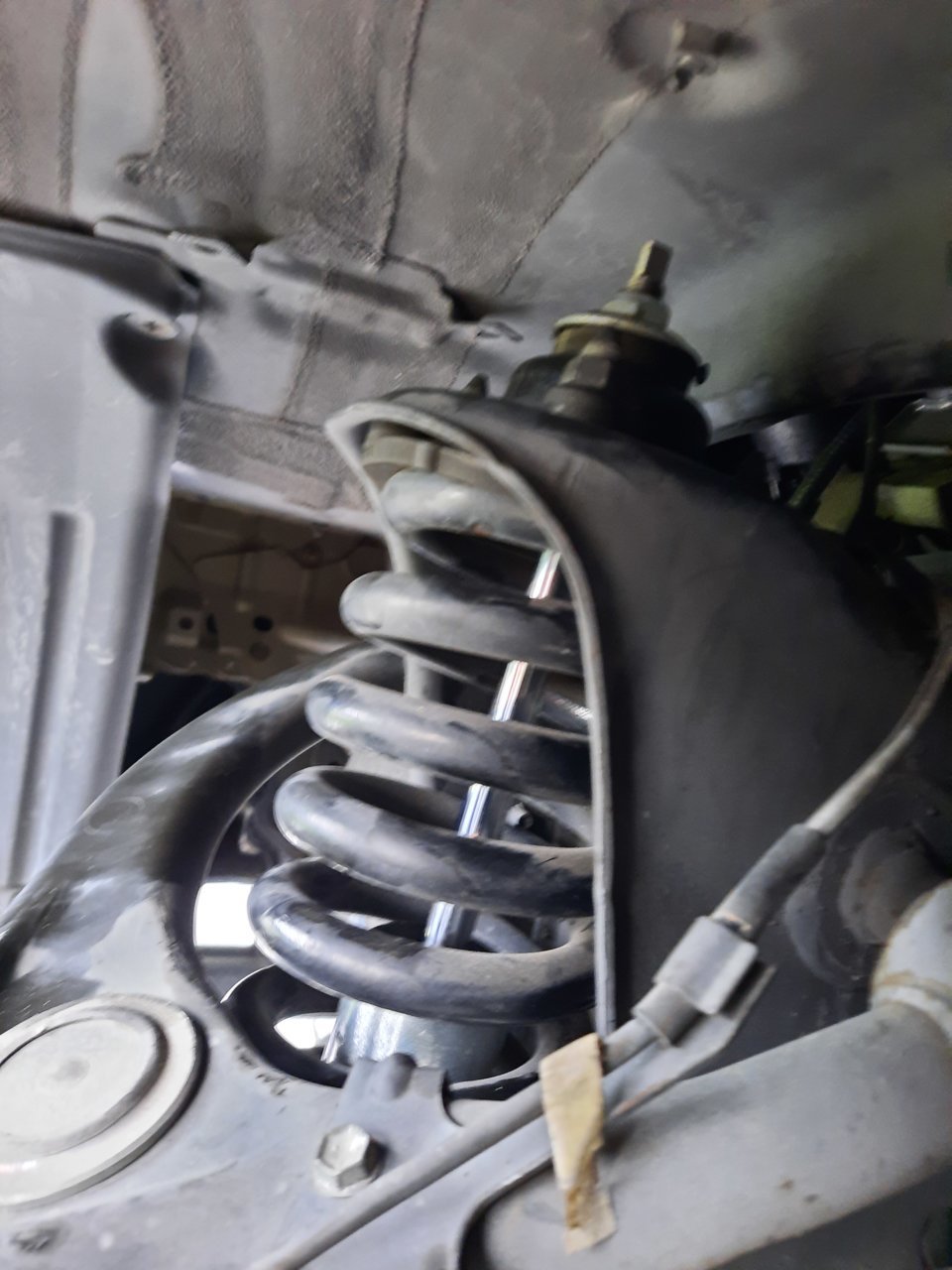

  6. Jul 9, 2021 at 4:55 PM

    Yup upside down

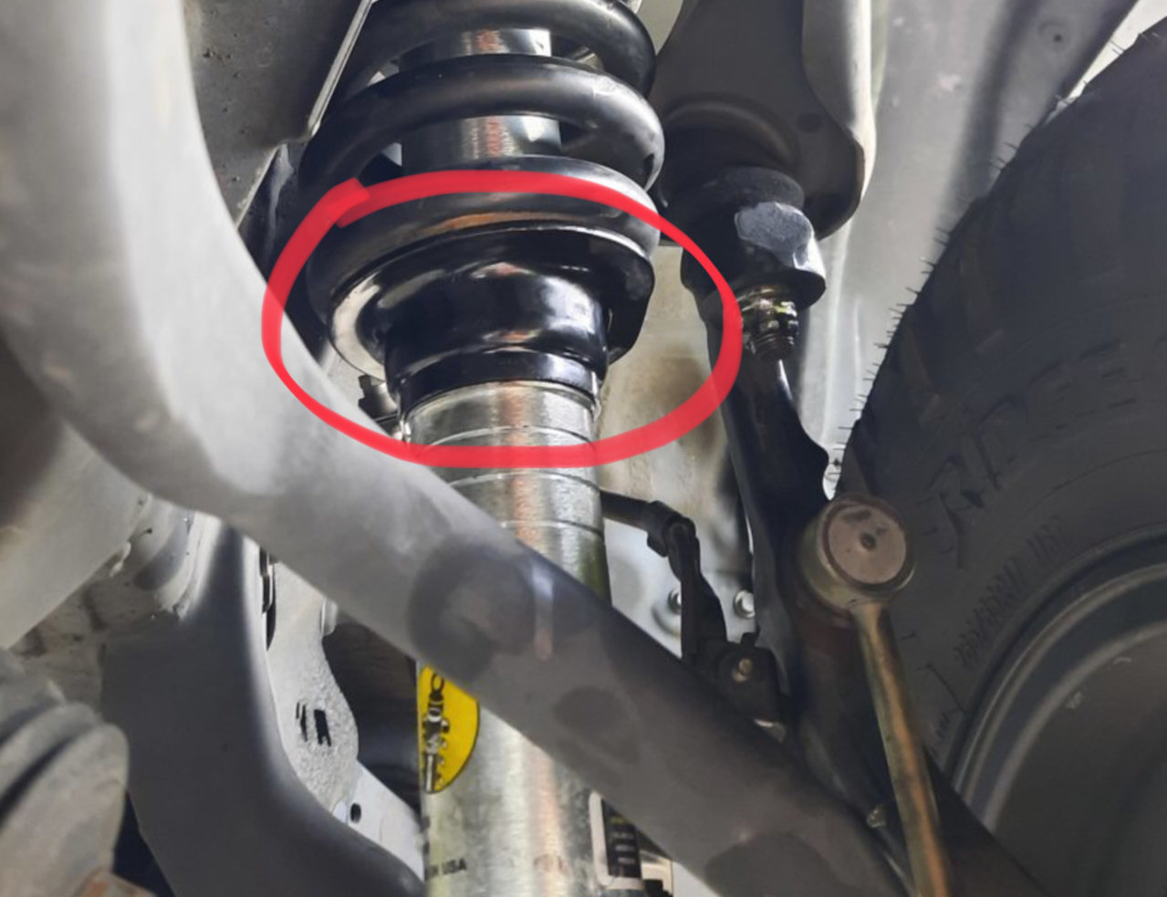

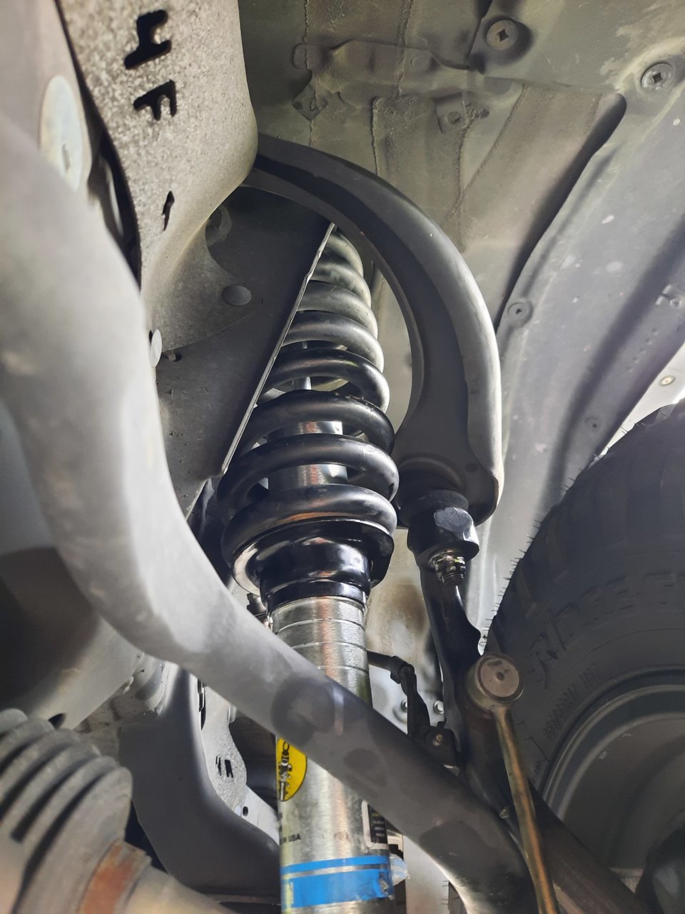

    The passenger side is correct

  9. Jul 9, 2021 at 4:59 PM

    They need to be taken apart and coil seat flipped.

    This one is correct

    Thank you for making the suggestion, I watched numerous videos in the event I got the courage to try it myself. I remember specifically seeing how the coil seat should be placed. I didn't even think to look until you suggested it.
