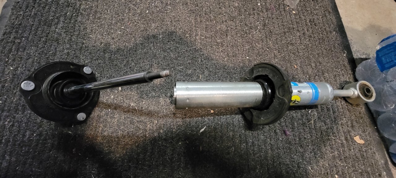

    One question, I pretty much drove around all day and went over several speed bumps because a few people suggested that they would settle. Could this error cause damage either immediately or in the future to my brand new shocks?

    I wouldn’t think so, if the spring perch is not damaged, it should be ok.
    I don’t know if it’s possible, but I suppose maybe the spring could max out before you hit the bump stop? I guess it depends on the distance between the perch gaps and total length of the collapsed spring. But I doubt you did any damage.

    Any damage would be internal, you wouldn’t be able to see.

    Nope, you are ok. Just flip the perch and all should be peachy :)

    751
    16 TRD sport
    All of them.
    It can rip the shaft out of the shock with that much preload on the spring. I've had 2 5100s come apart like that from being dumb and maxing out the preload on oME spring.

    All of them.
    This is what happens with to much preload and topping them out. I've had it happen twice and I've seen atleast a dozen other 5100s do the same. 20210322_154725.jpg

    Are you saying that it's going to happen in the future even if I get it fixed now?
