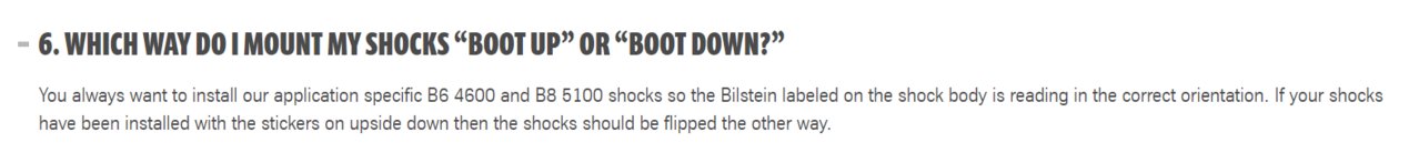

    Per Bilstein, the shock should be installed with the logo right side up. Looks like you installed them upside down. I would assume the benefits are that any dust, moisture and grime would collect on the bottom instead of on the inside of the shock body causing the rod to rub against it constantly. Other benefits may be keeping the shock body higher to reduce damage when offroading.
    https://www.bilstein.com/us/en/faq/
    Area51Runner likes this.

    Take it back to whichever outfit installed it and have them flip them or do it yourself. No sense in waiting and risking possible damage to your new parts. :thumbsup:

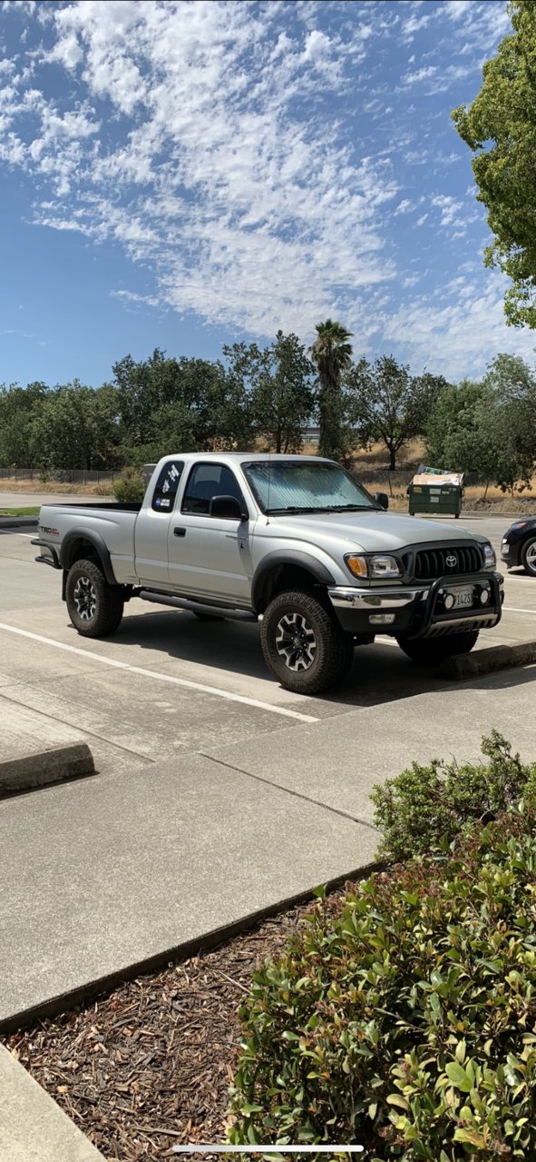

    I have stock suspension but added an ARB bumper and winch. I just want to get back close to level or have a slight rake while better supporting the weight. 881s?

    I’m still waking up but I think that will depend on the resting height of the rear if you want to maintain a slight rake. With that bumper and winch you *might* want to consider 882s, again depending on what is installed in the back. I have 881s up front with no 4x4 components or weight since I have a prerunner, and very little added extra weight. I have a slight rake with Deaver J59 leaf packs in the back.

    The suspension is stock style with no lift. After the parts, the front sits 2" lower than the rear, measured from the center of the hub to the fender. I would prefer it to be level but I would rather have a slight rake than it being squatted. I have no intention of going with any larger tires than the 31 10.5 so gaining lift isn't a concern.
