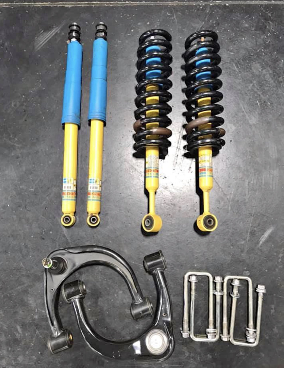

    I have a 19 SR5 2wd and wanted to upgrade my suspension a little. On a budget and found a set local off 18 TRD Pro 4x4. Will these fit and give me any better than I already have? $200 bucks

    They will fit, you'll have to swap over your old top mounts before installing them. U-bolts shouldn't be reused. Give you any better what exactly?

    These are not a TRD PRO suspension as stated in the OP. I wouldn't waste the money on this honestly..
    If I were you I'd start out with just some Bilstein 5100 series shocks, level out the Tacoma and call it a day at that. You can build off of those shocks down the road with an upgraded spring.
