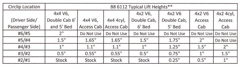

    6/5 setting will get you 2” and no spacer. Those settings compensate for lean
