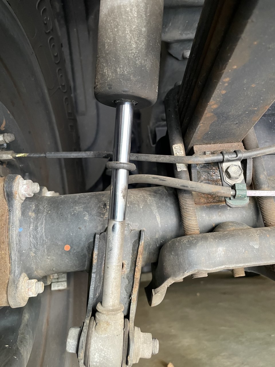

    looks like this. I remember spraying fluid film on the shocks to clean them so not sure if that’s what he’s seeing. Tires have ok wear, nothing crazy. I’m getting the sense this guy is trying to upsell.

    Yeah thanks guys. I also meant to ask... lets say all of my shocks are leaking a little. Wouldn't I feel it in the ride as well? And wouldn't I see oil stains in my garage from them leaking? All the guy pointed out was that there was a little oil/dark/dampness surrounding the body of the shocks, which may or may not be my fuild film I used when cleaning them a few times in the past year or two. Wonder if there is another way to know if they are leaking or not?

    Does the pic I posted look OK?

    another photo. Other side pretty much looks the same.

    I wouldn't worry about it

    Mine look like that with 50k on them. I’m not worried about it. The shocks are pretty cheap themselves already and super easy to install yourself. I’ll probably replace at 100k

    As suggested clean ‘em up and keep an eye on them yourself. I recently had my oil changed at a quick lube and they told me I had a bad power steering fluid leak. It was fluid film I had applied earlier this year.

    Your good :thumbsup:

    Thanks. Sounds like maybe the guy saw the darker stains and mistook for leaking? If my shocks were in bad shape are there any tell take signs? Good to hear they look ok.
