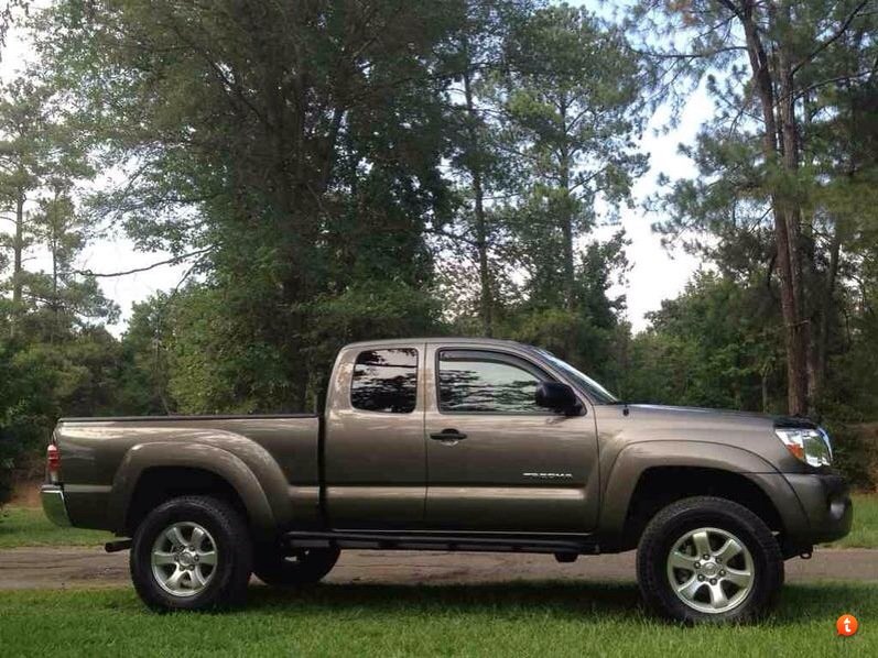

    afe pro dry, weather tech floor liners,5100's on all four corners@ 0, eibach 620 coils. toytec 3/4" spacer driver/s & passenger/s, rear spring tsb w/toytec 1" blocks, 4runner sport wheels, in channel vent visors, 1.25 spidertrax wheel spacers on the front, Wet Okole's, smity tow hook.
    My 2011 2.7L 5spd 4x4. I'm running 5100's front/rear, Eibachs, and toytec .75" spacers. I got roughly 2.5" of lift. No UCA's were needed and the ride/handling is 100% better than stock. As stated diff drop is not needed.

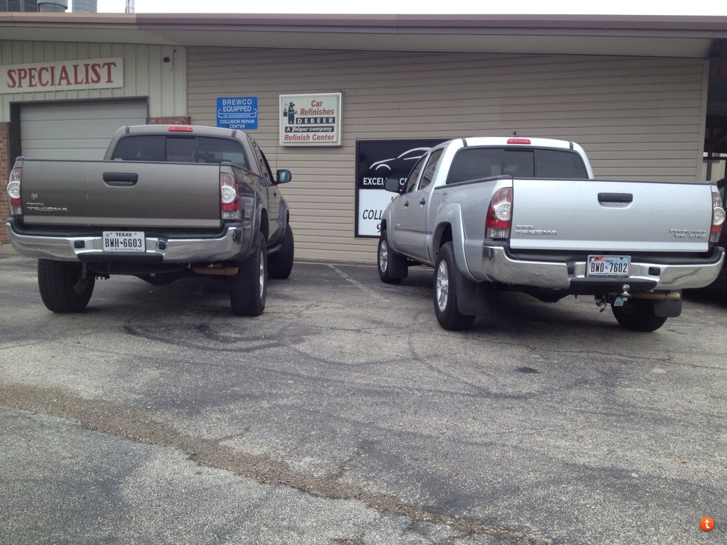

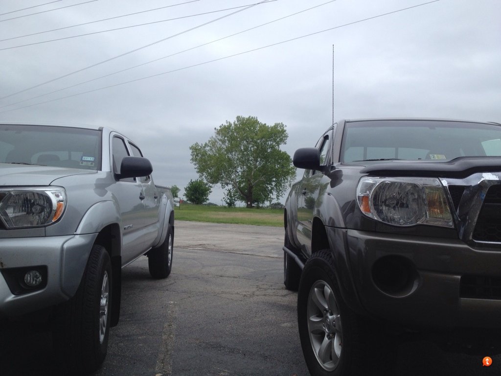

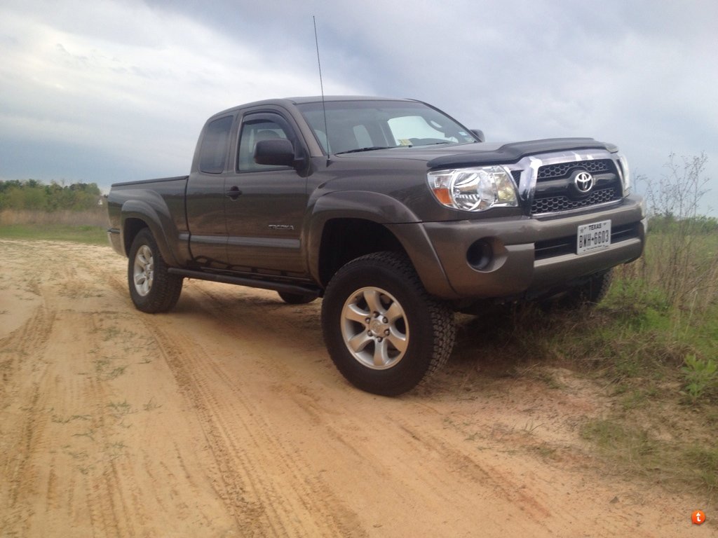

    y7ahe4yr_ca6a7cbbe0fb35ea3372d00492191f58149ed5b3.jpg4u7uqa8e_408fb213a2e538d19826884aec2aa263b6bb27a5.jpgbusyqeve_f2ee983edbfbe26c78a00d840ec534c6c1d3eef7.jpg
    Mine next to a stock 2012 for reference. Sorry for the crappy cellphone pics. I'm partial to the billies/Eibachs, but you can't go wrong with OME either. On a side note I wouldn't waist your money on the toytec ultimate kit if your going to spend that much $$ get a coil over you can rebuild.gubezy8u_3311f156fd4574bf91fabe7bba0554e51e7c4863.jpg
