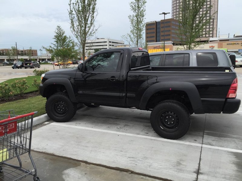

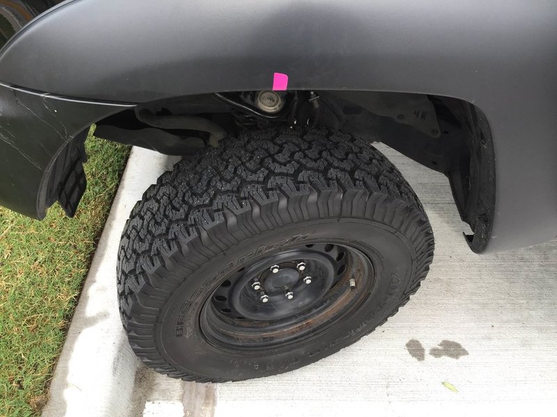

    I do have these photos just to show how high it is. Obviously these won't help determine if the install was incorrect, but you can see the result.

    sorry for the off topic question are those the rims for the spare tire ? I like the look.

    They are rusty old steel rims. The previous owner transferred his wheels to his new truck when he traded it in, so these are probably just the cheapest things he could find to throw on there.
