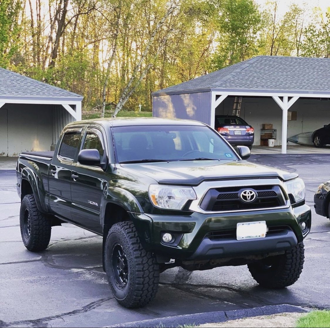

    So i've got a 2013 DCLB that i've already installed a spacer lift in the front, and a aal in the rear with 5100's. The front has sagged about 2's and I wanna replace them. I have my eyes on either the Bilstein 5100's with OME 888's, or the Toytec coils with Bilstein 5100's (SKU TTAFCS-HA). I've heard stories of both sagging after just a few months to lasting years with almost no droop. Just looking for some extra input before I spend the money. My budget is $500-600. Attached is the truck when the lift was first put in. Thanks guys! :D

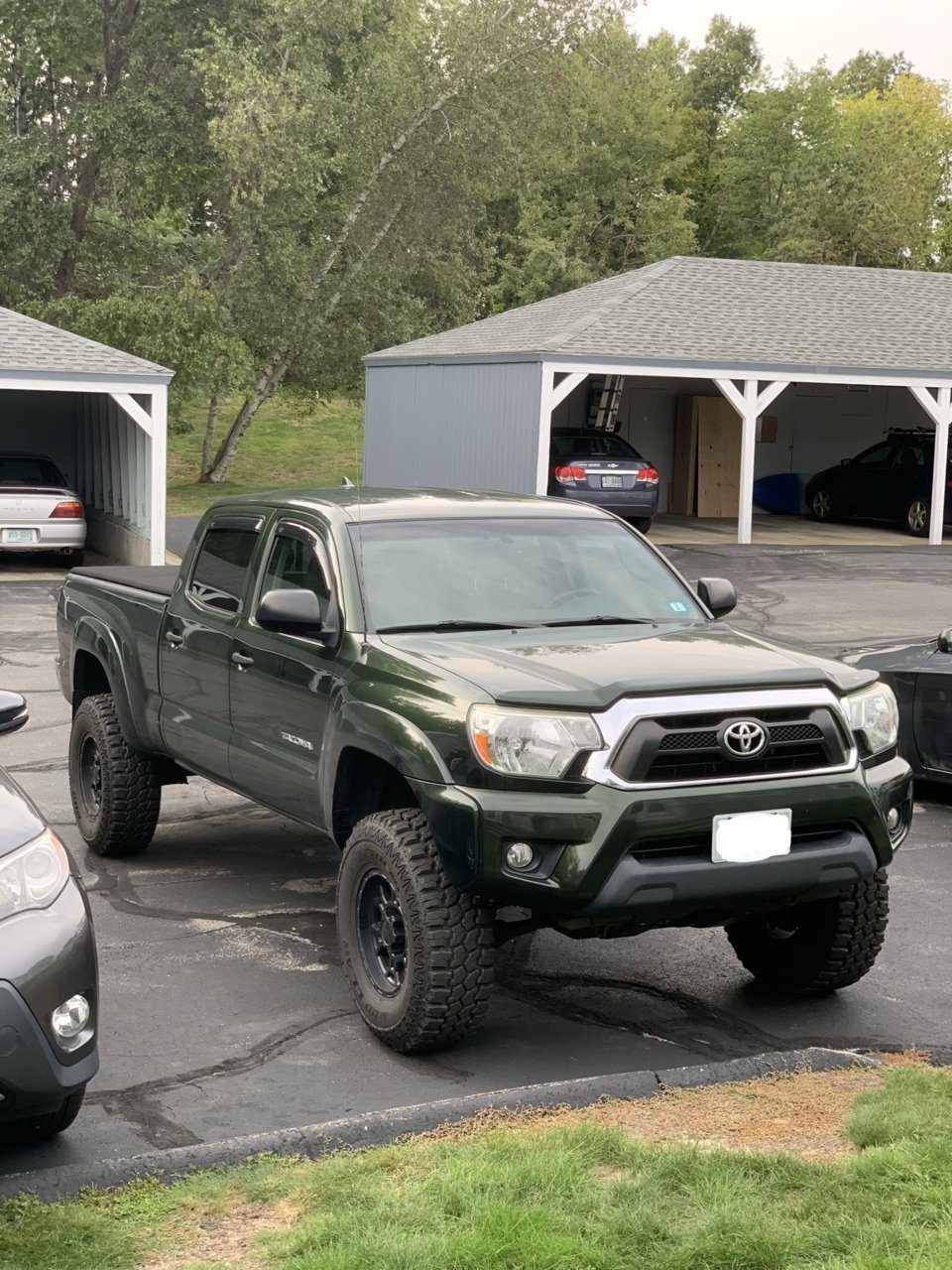

    I ended up going with the 5100’s with the OME 888’s. Extremely happy with the result. It brought me back to the desired height, and the ride is comfortable yet firm on the trails. Would definitely recommend to others! Don’t have any rub as of now, but I’m gonna run some 1.25” spidertrax spacers. So I made an appointment at a local shop to have the cab mount chop done.
