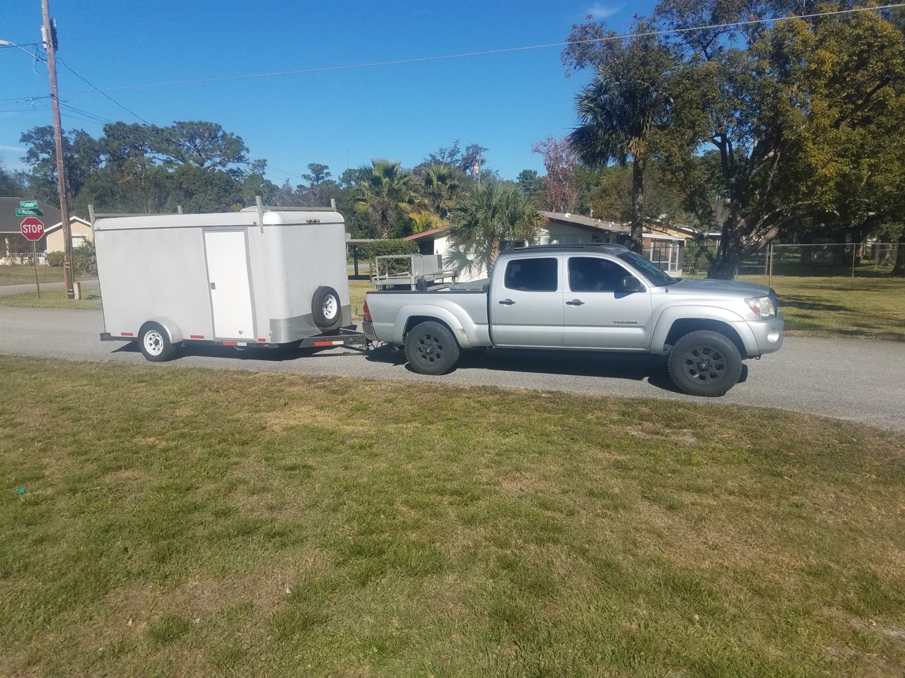

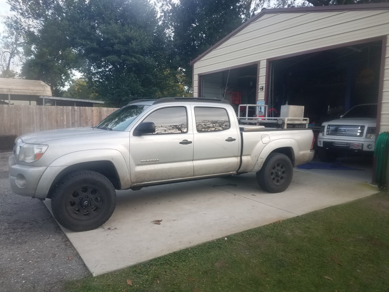

    Tires arent the biggest deal, I want my truck for off road performance not really rock climbing or anything and to haul my trailer. Right now it has 5100s all the way around that are worn out hence the new stuff....I am not sure of what all is on there other than 5100s

    Looks like you need to upgrade your leaf pack.

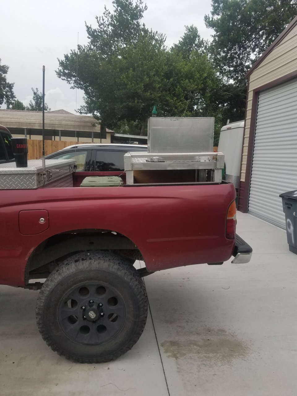

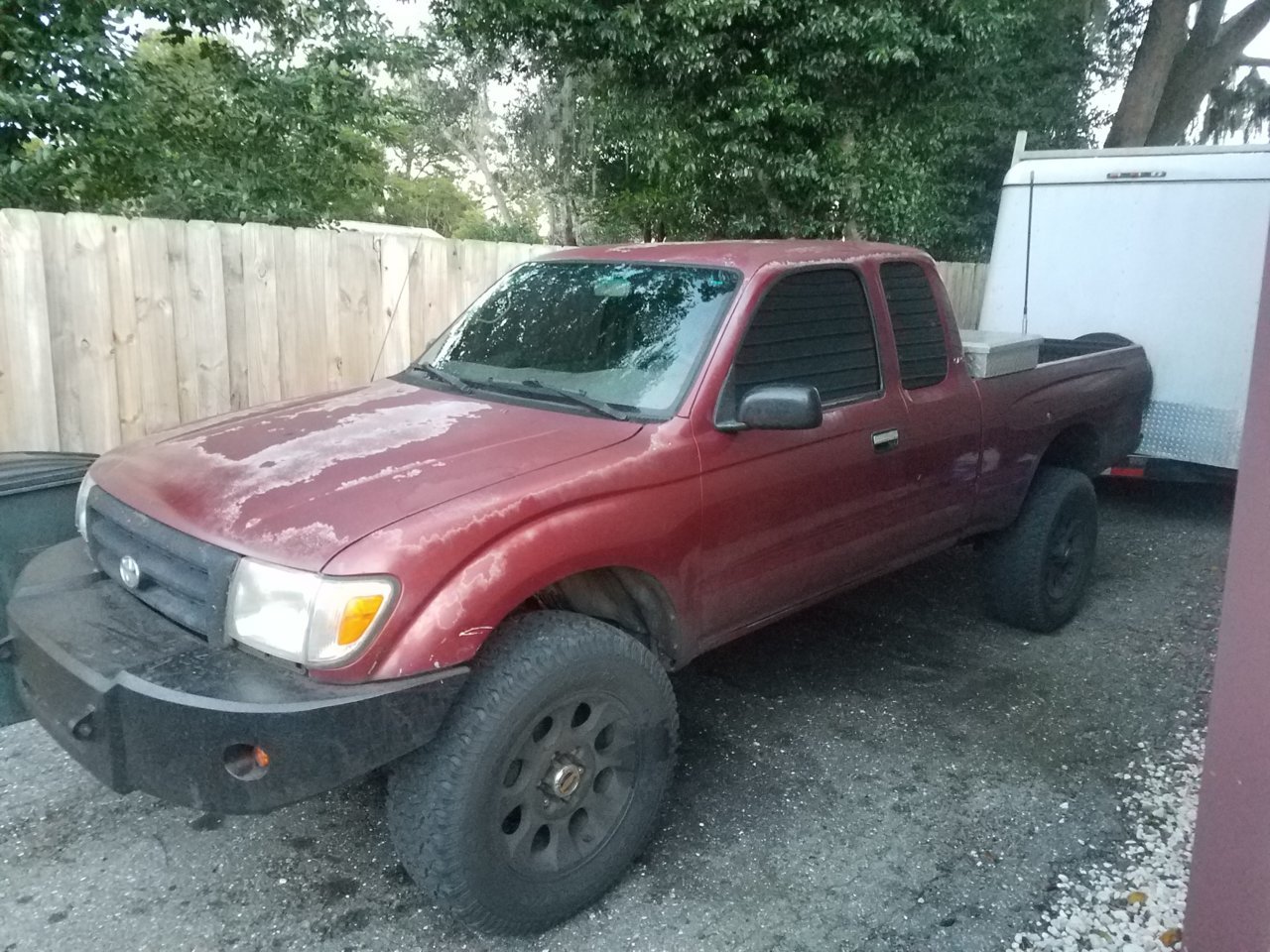

    Yes, but I want to keep my soft bump absorbing ride also. My first gen I just sold had an aal and it was alot rougher
