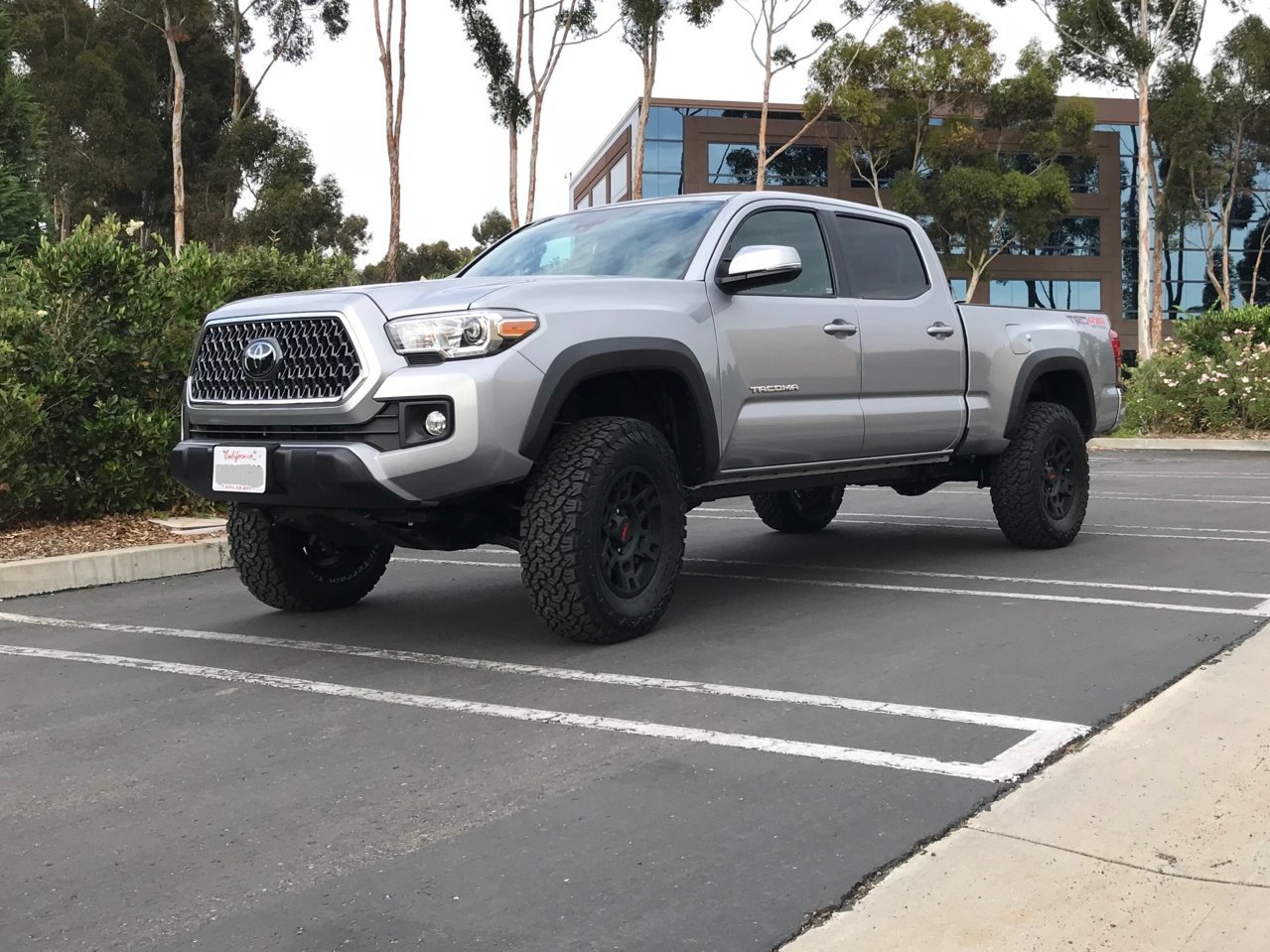

    Ok. That's the way I'm leaning so far. Besides not taking out the factory over load due to pulling a camper. Thanks for the input. Do you have any pics of your truck?

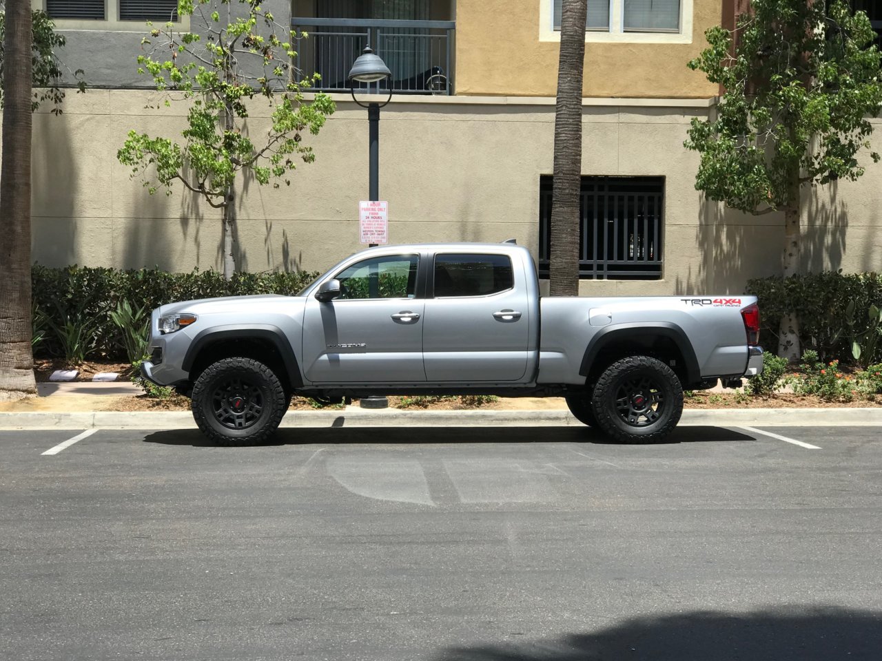

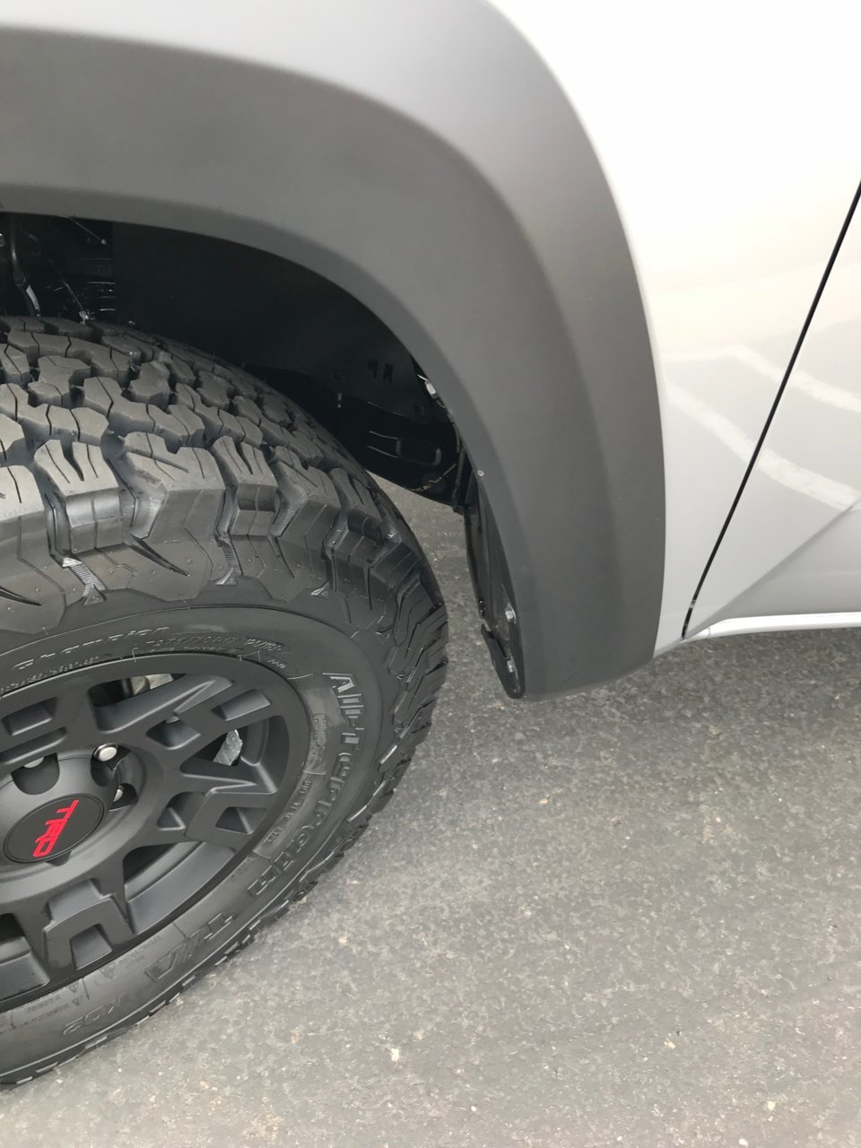

    Here you go! I went with 275/70/17 tires which haven't rubbed yet and have pretty good clearance due to the wheel offset. If you retain the factory overload, I was told it will give you an extra 1/2"
