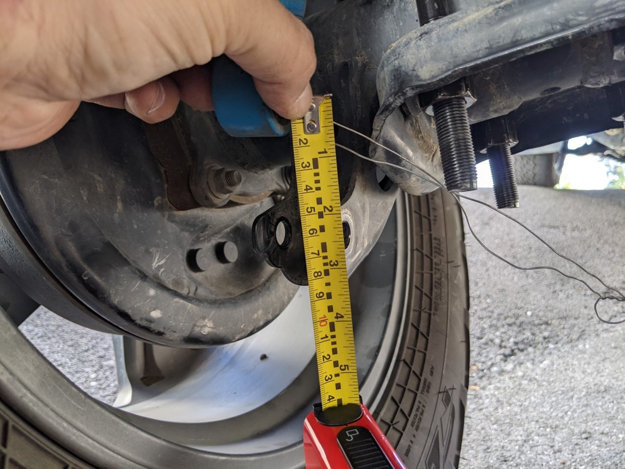

    1.0in lift on a 2nd Gen. There are pics around here somewhere of a 5100 next to a stock 3rd Gen Hitachi. They are the same overall extended length.
    Yessir!
    I've been meaning to recheck my numbers, but this was after I got everything installed, which was 4k on the Icon leafs:
    LF: 22 1/8in RF: 21 7/8in
    LR: 23 5/8in RR: 23 1/4in
    Basically 1.5in over stock with a fuzz of anti-Taco Lean.
    Here's the stocker with new Icon RXTs at Option 1:

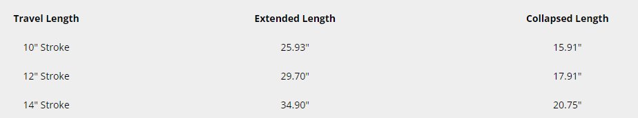

    Bilstein 5125s look like they can come in several different lengths/travels. The one listed above is the normal Tacoma suggested model. Here are some more non-model specific it seems. or for modified vehicles.
