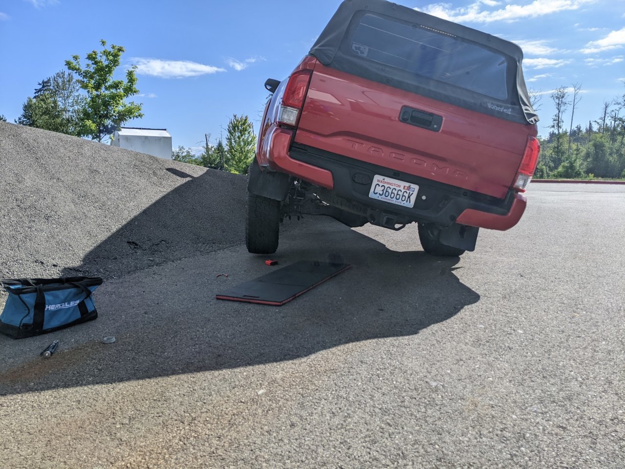

    I know this is a tangent given where @1776Taco is now going, but here's a pic showing the bumps were still working with my particular setup.
    :cheers:

    ...but the pack thickness is a fairly consistent property of a given leaf pack. I would have thought the spring manufacturer has this compressed/relaxed distance info for a particular, otherwise stock vehicle. But I suppose if one is replacing leafs, they can't assume you're using the stock bumpstops (or shock mounts, for that matter).
    :anonymous: I was concerned about compressing the springs, not the shocks, and that would take hundreds of pounds of force. Hadn't considered that the weight shift from one front side to the opposite rear would do it.
    Thanks for the photo.
