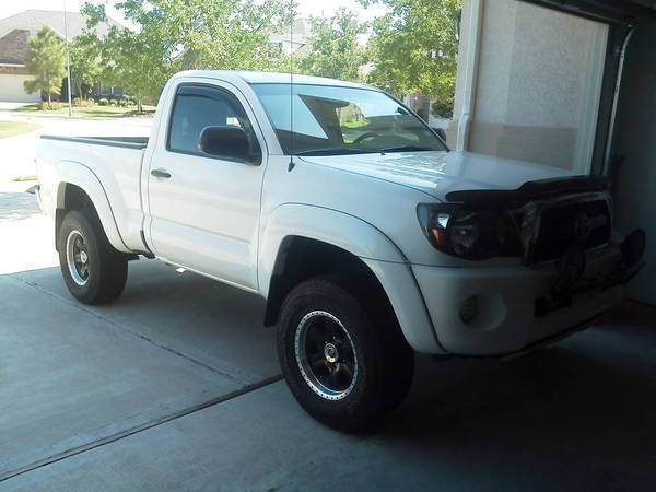

    T@co_Pr3runn3r
    T@co_Pr3runn3r XXXXXXXXXXXXXXXXXXX
    Jan 20, 2009
    #12767
    14,577
    08 RC Prerunner SR5
    Here is non tsb 3 leafs with 5100s set at 1.75 up front. Has 1.25" rake higher in back. RC tho..............need better side shot but you get the idea. 265/70/16s

  13. Aug 28, 2013 at 2:19 PM
    #173
    CO Taco
    CO Taco Texas Aggie
    Dec 17, 2012
    #93277
    92
    Tyler
    Fort Collins, CO
    08 SR5 4x4 Black
    Weather Tech Mats, GTA aux adapter, Plasti-dip emblems, radio
    thanks for the pics T@CO. interesting to see how the lift affects the reg cab.
