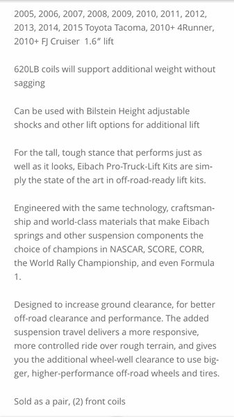

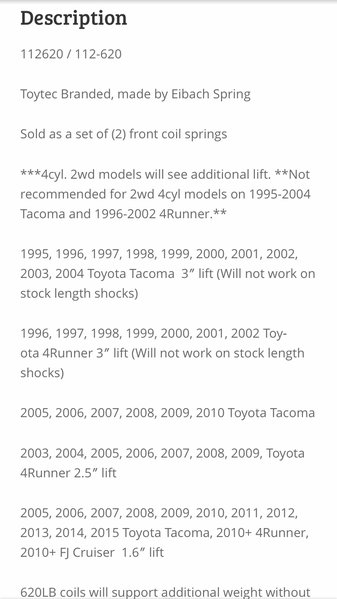

    OME 881 or 882 Coils and 5100's should be a better ride then the Eibach springs which are rated at 650lbs

    Pretty sure eibach is 620

    Yep 620lb coils

    I agree the Eibach 620lb coil is not the best riding option but it is better than the coil spacer! Much better! If you get the light racing UCA, I felt as though my handling was better on the trail with bump steer
