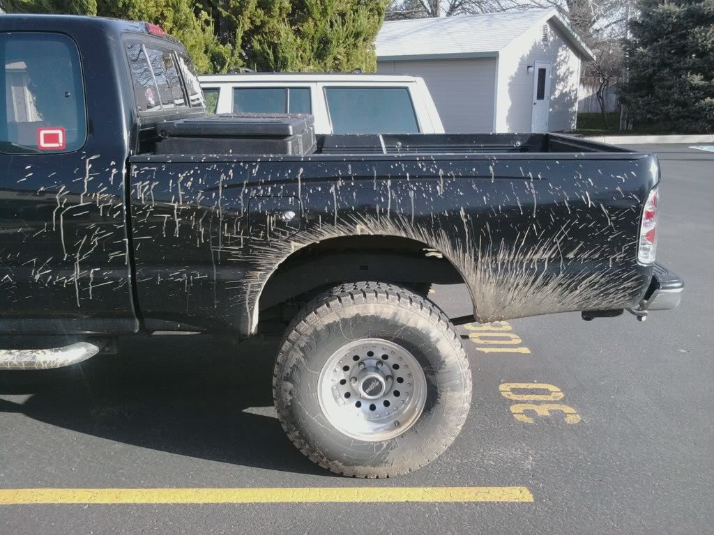

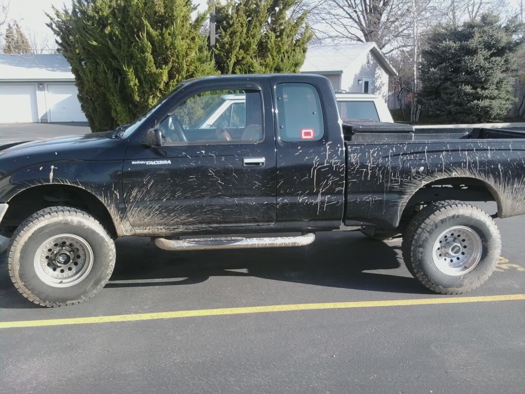

    5100s are the best for these trucks. They are 0-3" lift for the rear and the fronts are adjustable 0-2.5". I just put them on my 04 and i love them. Your truck dosnt look lifted to me. It might have a leveling kit on it but the rear look stock. My fronts are at 2.5" and i put an AAL in the back and it rides great.

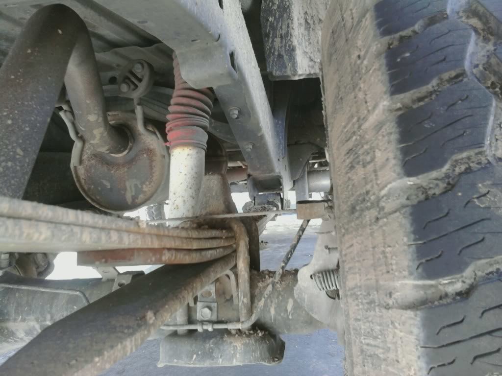

    The rear has a add-a-leaf. Need a pic to see what the front has. But if you do run the 5100s, you would remove the current lift components in the front and just use the 5100s to get 2.5" of lift. For the rear you can just get new shocks since you have an aal. However, from the pic, the aal that you have is not a good one and could damage your pack.

    Up to 3" but 5100's can max at 2.5" alone, you will still need a rear lift...your rear leafs are decent shape so a AAL will work but I would get a new leaf pack if I were you.
