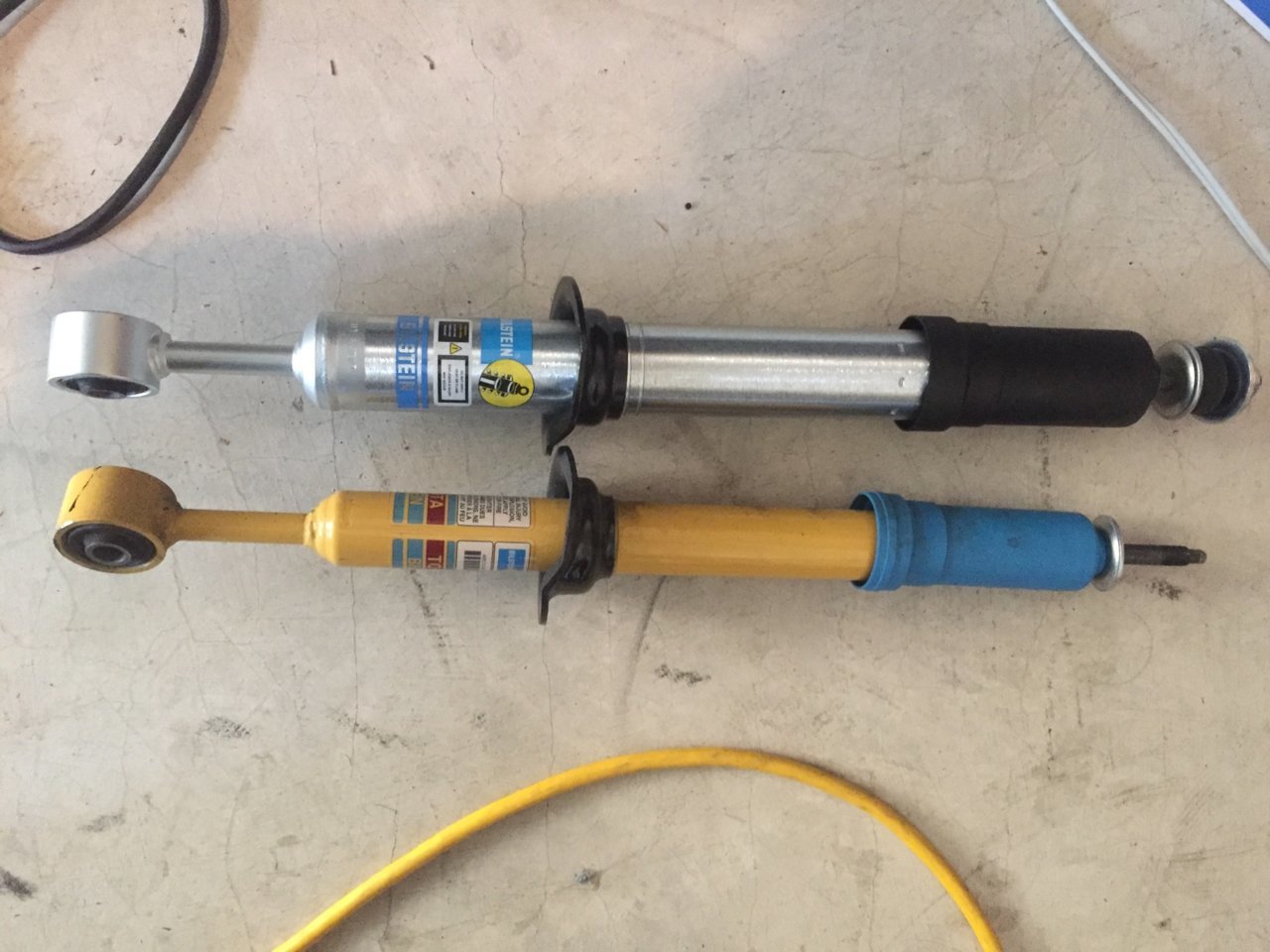

    There’s definitely a difference in size, handling and performance.
    The 5100’s are a firmer shock, with valving that is different that the stock 4600’s.
    You can of course keep the 5100’s at stock height on the front, or adjust for a bit of lift. The spring remains the same length at all settings once the weight of the vehicle is on the spring, so the ride firmness remains the same at all heights.
    Moving the circlip up, increases the length of the bottom tube of the shock, which provides lift.
    I liked the soft ride of the stock shocks, but not while driving in curves and taking corners, so I installed the 5100’s with under 1000 miles on the stock Bilsteins.
    The 5100’s provide a firmer ride with less lean and roll in curves and for the modest price, they might last a bit longer on washboard roads before crapping out.

    Thanks for the very detailed answer. Glad to see someone who personally went through these steps.
    So from your experience, the 5100's are slightly firmer. I personally don't mind that too much. Although I do like plush rides. However, I agree that the Offroad rolls a bit more than usual on corners.
    Here's a question: When you put on the 5100's, which springs did you go with? It looks like some stores offer them up with OME springs, which others stick to Bilsteins only. What did you end up doing?

    Thanks for the links. Believe it or not, I actually did not know that the factory Bislteins were 4600 series. Now that REALLY clarifies things. Honestly, my biggest concern was that if I ever went to 5100's, it wouldn't be a substantial upgrade from stock. (Lift or not)

    5100’s are definitely more firm in a good way. Still a very comfortable daily driver ride, but with MUCH less body roll.

    also front 5100's are LONGER which will provide extra droop.
