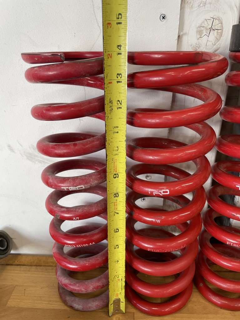

    First, springs. Not surprisingly, the springs were identical in length, at 14".
    Pro (600lb) on the left. Baja (650lb) on the right.
    They appear to be identical but obviously it's understood they have different spring rates.

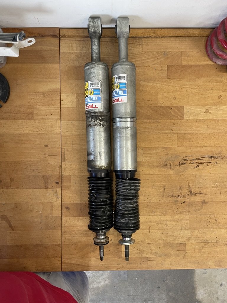

    Next up, the shocks. Overall length, and overall design look identical at first glance. They seem to physically be based on the same basic shock body and design - modeled after the 6112 Bilstein as we all know. So, no real surprises there.

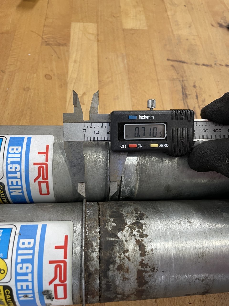

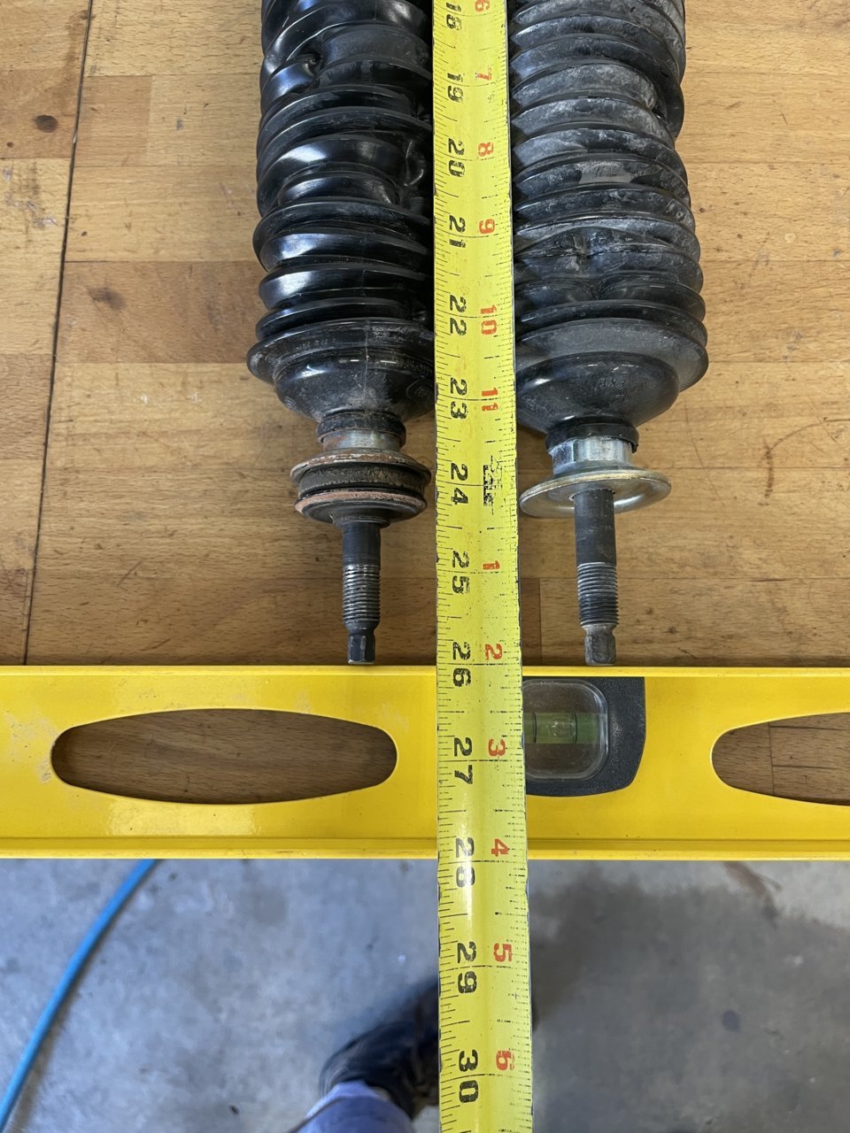

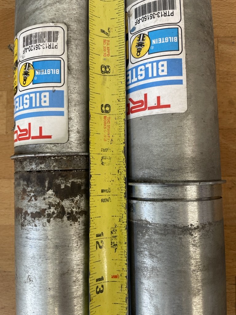

    So, what's the difference? Turns out there's a, not insignificant, difference in circlip location. As you can see, there's a 0.7" / 18mm difference in the location of the grooves for the circlips.
    The Pro shocks (with lower spring rate) have the grooves higher up than the Baja shocks (higher spring rate). This makes sense as the Toyota engineers essentially increased the preload on the Pro in order to create the same amount of lift as the Baja despite the lower spring rate. That said, this was more of a difference than I was expecting. (I imagine if you do the math then it probably checks out.)
    Baja on the left, Pro on the right.
    Pro on the top, Baja on the bottom:

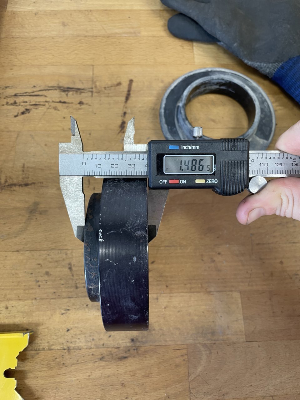

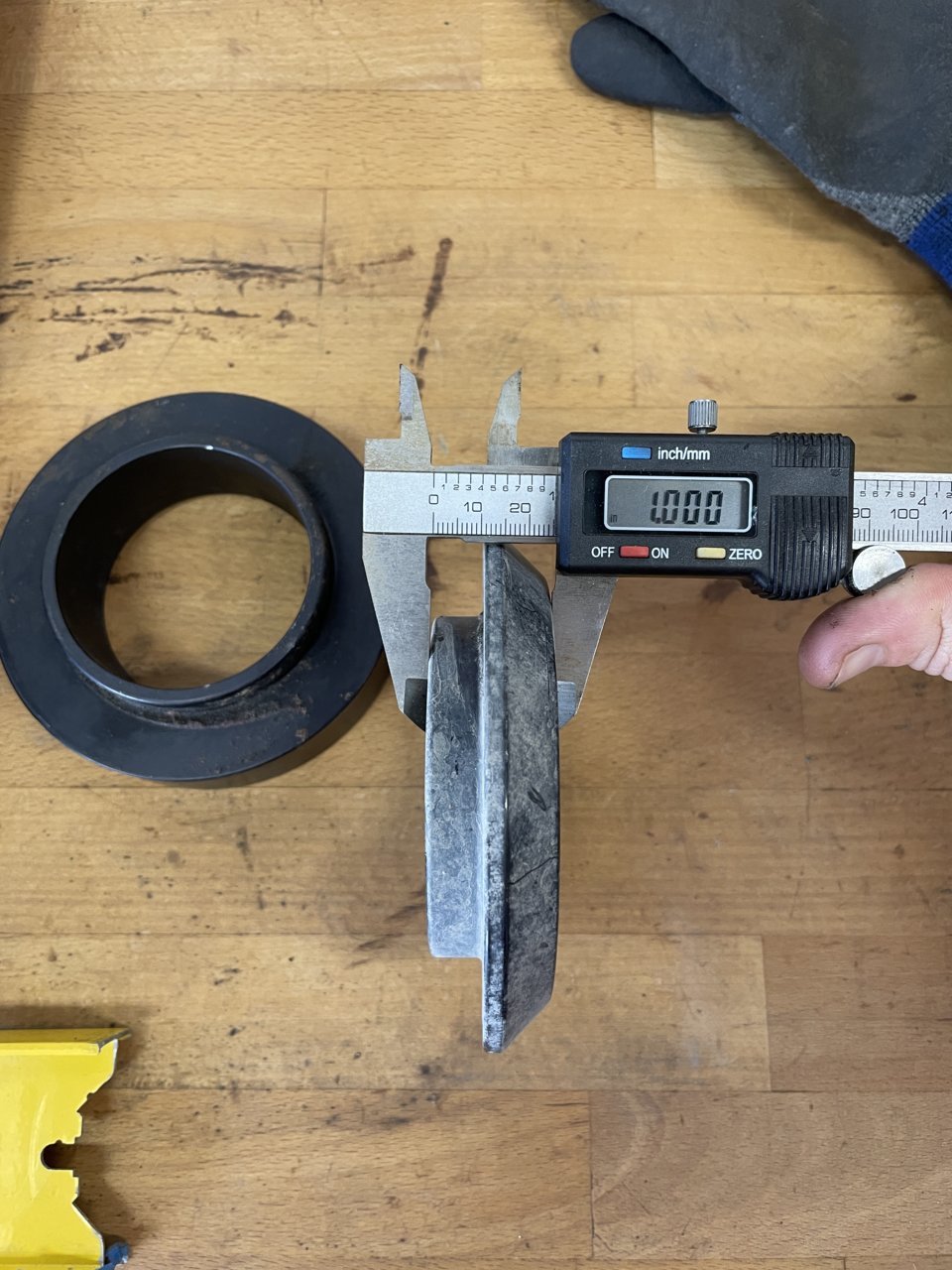

    And since I had them on hand I figured I'd provide some measurements on the factory spring perch vs the Toytec 1" Baja spacer. The Toytec spacer is 0.5" thicker than the stock spring perch. 0.5" of added preload is how they give the 1" of lift.
    Stock spring perch:
    Toytec 1" Baja Spacer:
    This suspension is pretty old by now but hopefully someone out there will find this info useful.
