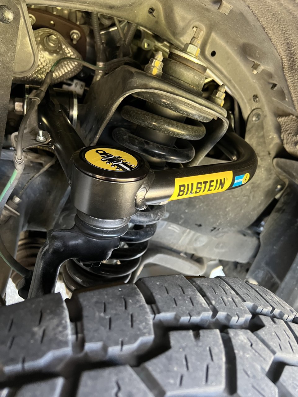

    I bought the Dirt King dust covers for my Bilstein UCAs.. they fit like a glove.. I had @thedecalgarage IG make me some custom vinyl Bilstein to cover the DK on the caps.. it looks legit :thumbsup: .. I’ll submit some pics next week when I have them all installed

    Very nice. You running stock lowers?

    Who are you asking?
    For me, yes I just did the UCAs. Lower control arms stock.

    6503F5DF-3812-4354-B452-3671F0F9639D.jpg It looks super clean now

    Looks dope!
    How's the ride? Does your steering wheel shake when accelerating?

    Feels a bit stiffer but no shaking w acceleration

    is B now making dust caps for these or did you make your own B decals to put over the dirt kings?

    Yes.. had some custom vinyl made to go over the DK on the caps
