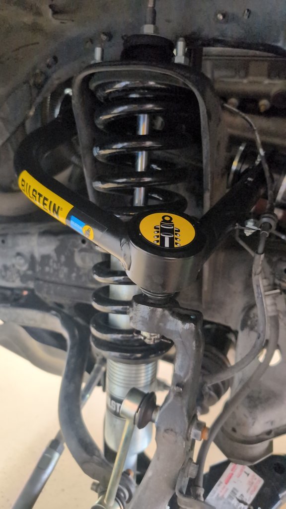

    I was able to press my bushing in using a vice. It took a few tries, but once I got the first one in, the other seven went in faster. Kinda weird how the instructions say to press them in "dry" I added a bit of grease to the ends. Planning to install the UCAs today.

    Finished. Now clean up.

    Looks really good.. job well done

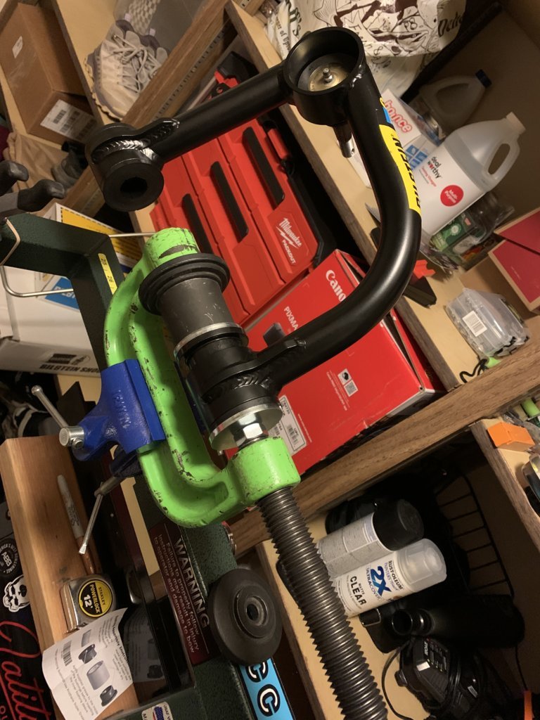

    For anyone wondering if the ball joint press works for the bushings, it does! I wouldn’t have been able to do it though, had I not picked up a M14 x 1.50 bolt and nut from the hardware store. I used the bolt to mostly keep everything together and to guide the bushing in. Trying to do it without the bolt was an extreme pain in the ass and would not recommend. For anyone interested in trying:

    That’s a smart way to install the bushings. I used a vice, but I would’ve done it your way since I have the same tool. How are you liking the UCAs? I haven’t had any issues with mine so far.
