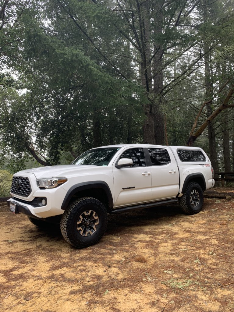

    Minus the deposit for the tool, it was free too! Cant beat that if you don’t have an option for a press.
    Im loving the UCA’s! I’m running them with the 6112’s and 5160’s in the back and the ride is soo buttery smooth! No complaints here!

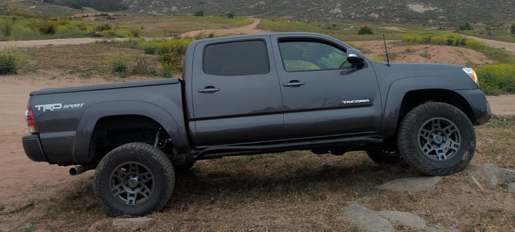

    2014 4x4 TRD Sport DBC

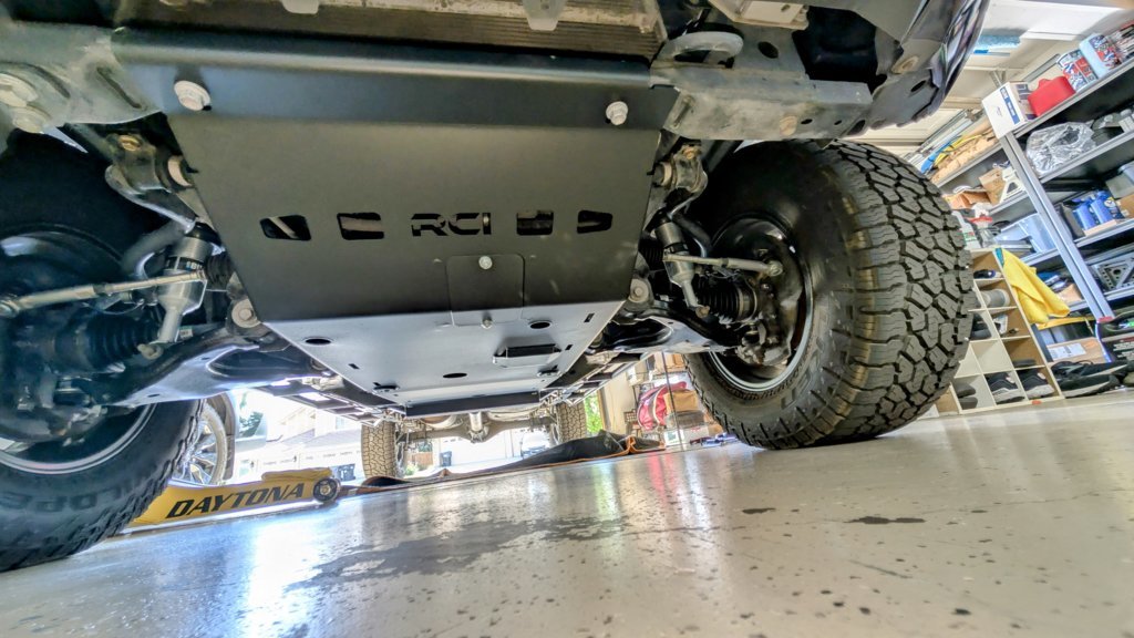

    I also have the 6112's and 5160's. The 6112's are set at 7 and 9. I'm running 265/70/17 Falken Wildpeaks. Just installed steel RCI skids and rock sliders. I might need 650 springs later if I add a low-profile bumper and winch. As for the ride, I think it feels good, but I do notice all the small bumps with the 6112's.plate.jpg

    Im running 285/75/16 with the Icon AAL. Im running the same clip height and did zero cutting when throwing on the 285’s, plenty clearance if you’re thinking about runnin 285’s.
    Might be worth to it add the info, but after installing the suspension I drove home about 150 miles to do the 285’s and the alignment the next day. The initial suspension install didn’t throw off the alignment hardly any.

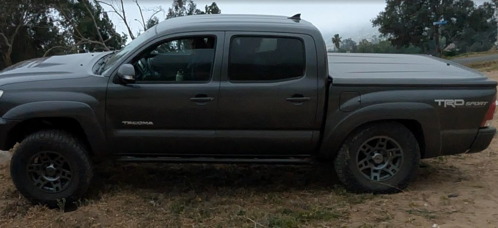

    You’re running 285s with the same setup as me? Damn. I just bought these tires and they look a bit small on the truck, especially in the rear. I went with 265s thinking they’d give me the best clearance for off-roading without needing to cut anything. Now I’m wishing I had at least asked the tire shop to test fit some 285s.

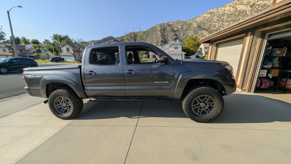

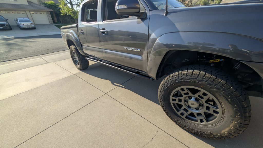

    See, I'm not sure I can just throw some 285's on there. I would need to do some cutting . See my pic of the rear.
