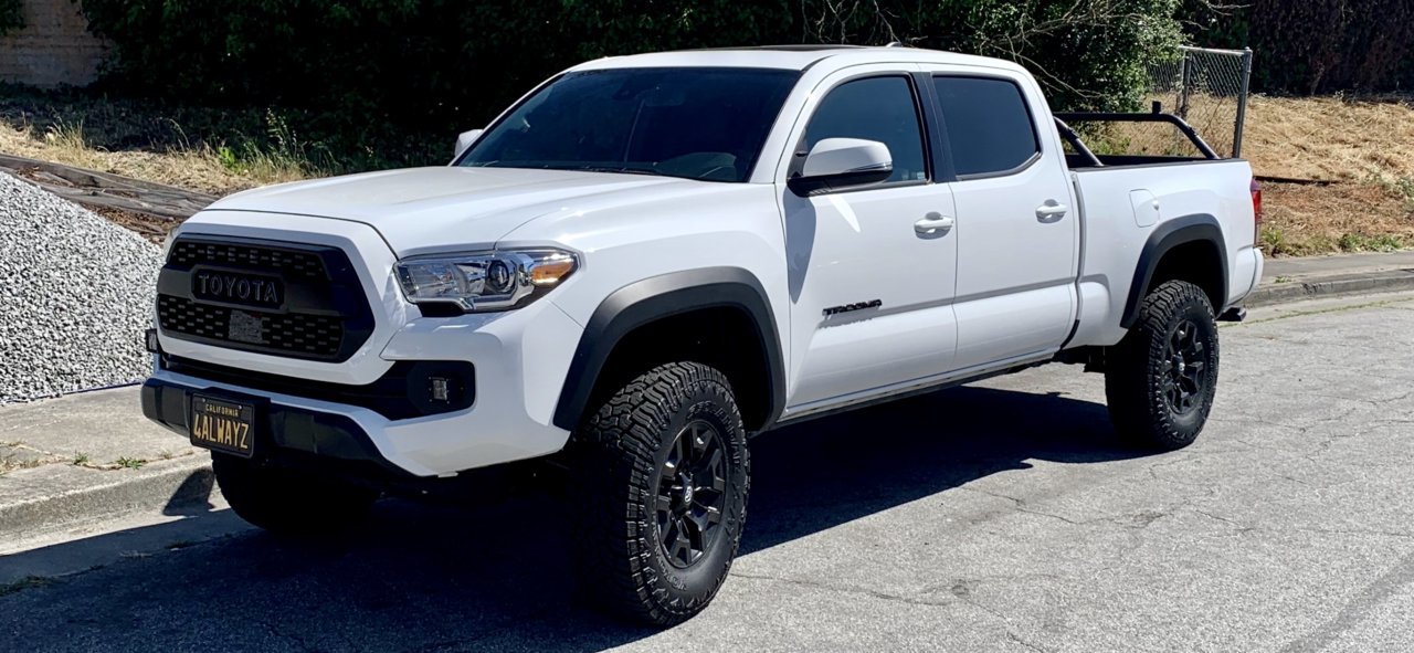

    It’s difficult to beat the overall quality & performance of the Eibach kit for the money. They did a really nice job with it. I’m very pleased with my setup, both on & off-road. Zero regrets & I highly recommend it. Eibach’s warranty is second to none as well.
    I gained 2.25” of front lift on the first clip and used a 1.5” block in the rear. I also installed a .25” top plate spacer on the driver’s side for the “Taco Lean.” I ordered everything through Headstrong and had them pre-assemble my fronts. Total to my doorstep was $750.
    I went with 265-75-16 KO2’s on Gunmetal Ray10’s. Zero issues. Power and MPG’s are still fine. No need for cutting my truck or regearing. I see no reason to go with a bigger tire, unless you really need that little bit of extra clearance. I was able to keep my mud guards and have zero rubbing. I did have to replace my front needle bearing with the ECGS bushing after developing the typical vibration post-lift. Hope this long post helps.

    Lookin good @IrishRed
    I personally think that's the perfect height.

    Eibach Suspension, JBA UCA’s, 16” SCS Ray 10s, BFG KO2s, ECGS Bushing, Pro Skid Plate, Fumoto Valve, Pro Grille, Opt7 Tailgate Light Bar, AVS Window In-Channel Vents, Roknlokz XL Mud Flaps, Husky Floor Mats, Bed Mat, Tailgate & Glovebox Letter Inserts, TRD Grille Badge, Exhaust Tip, Toyota Hitch Plug.
    Thank you! I’m certainly a bit biased, but I agree. I’m very happy with it.
