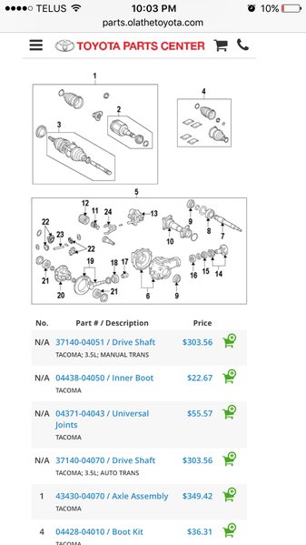

    Smitty99 I guess that's another issue for your truck. Drivers and passengers cv axels not the same length but the parts list says they should be.
    Sorry to hear yours didn't include the output shaft to allow them to be the same length.
    Bushing is already on passenger side, needle drivers side only.
    Sorry to call you out on this, but misinformation should be corrected.

    Yeah that's right I received bad info from a tech when we were discussing the issue with this bearing and why it fails. It's actually due to the slop in the way the spider gear and carrier are designed. The drivers side is the problem because it has a needle bearing and the passenger side has a bushing. Why they put the needle bearing which is prone to failure on the drivers side, is another discussion I guess.
